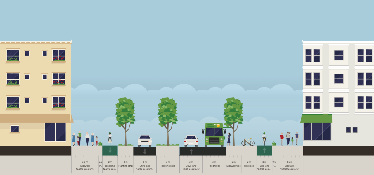

Definitely retain trees. Spitballing because I'm bored, but retain the current Sanders Blvd setbacks, you've got a nice wide ROW to do something interesting with:
The deepest part of this community (furthest from Main) is just over 500M away. At that point your starting to get into car-preferred distances.
I mean students already live further away. 500m is not really an outrageous walking distance and if you control the amount of parking in a hypothetical development, you can somewhat self select who lives there.
No its not outrageous by any means, but statistical analysis does show that's a distance to transit, or grocery or school where things start to shift into car orientation. I'm not arguing against your idea here, I just think its important to fix the stroad and stroad adjacent areas first.
The simple act of shifting the Fortinos to being up against Main, with parking underground would be a game-changer for how people live and get around in the area. That, however, won't happen without a mid or hirise development under which it can locate.
