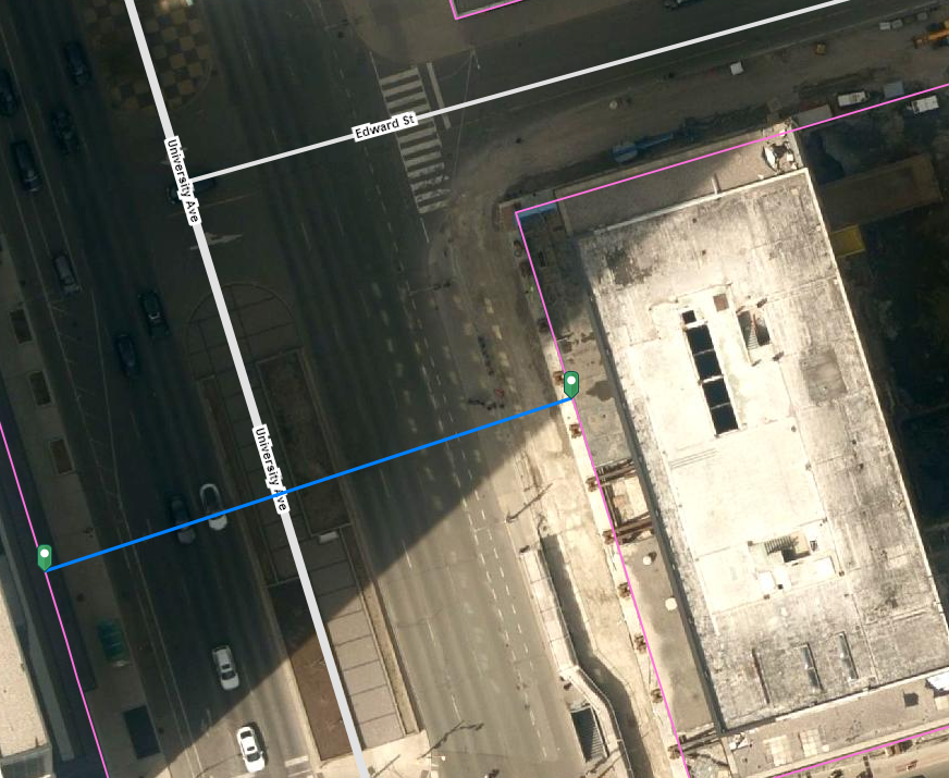

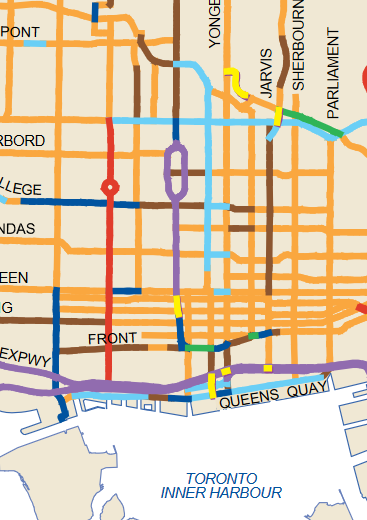

Below is the Right-of-Way Width map for the City. University Avenue is mostly in purple which is 45M or greater.
Here's a real world distance measure of the University Avenue ROW just north of Dundas:
That line is 55.1M wide.

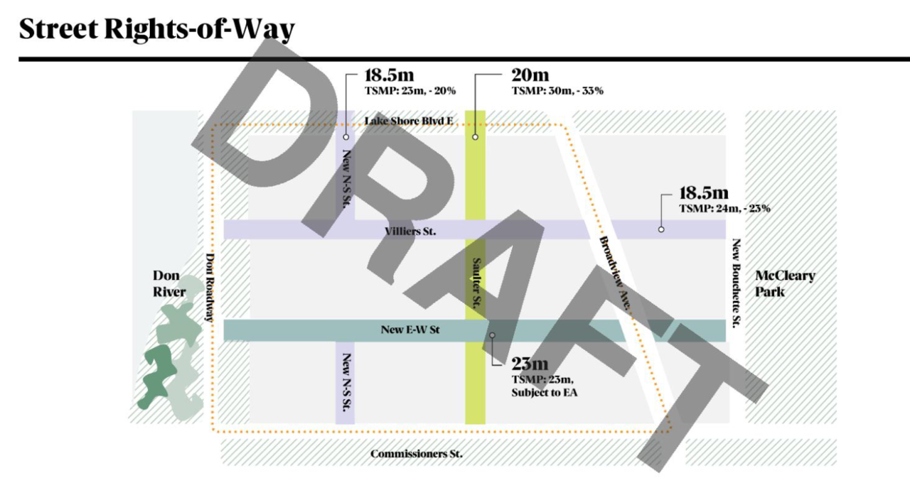

Ok......so I promised more on McCleary........let me extract from the presentation to the Waterfront DRP:
* note that this is the July presentation. Alex mentions a meeting from last week, the agenda for which does not show the district materials as being discussed, but rather a series of discrete parcels/projects.
From: https://www.waterfrontoronto.ca/sit...ecinct-Plan_Stage2_Preliminary_Draft_Plan.pdf
Let me also offer up the minutes of the July meeting which are now public:
Lets start with the street grid and associated ROW widths.
Lets stop for a moment and note a couple of things:
1) ROW is not curb to curb, but building face to building face. It includes the car-travel lanes, but also cycle tracks and sidewalks and any landscaping within boulevards.
2) You'll see little minus signs above followed by a percentage. This reflects how much smaller the ROW is now proposed to be vs the first iteration of the plan.

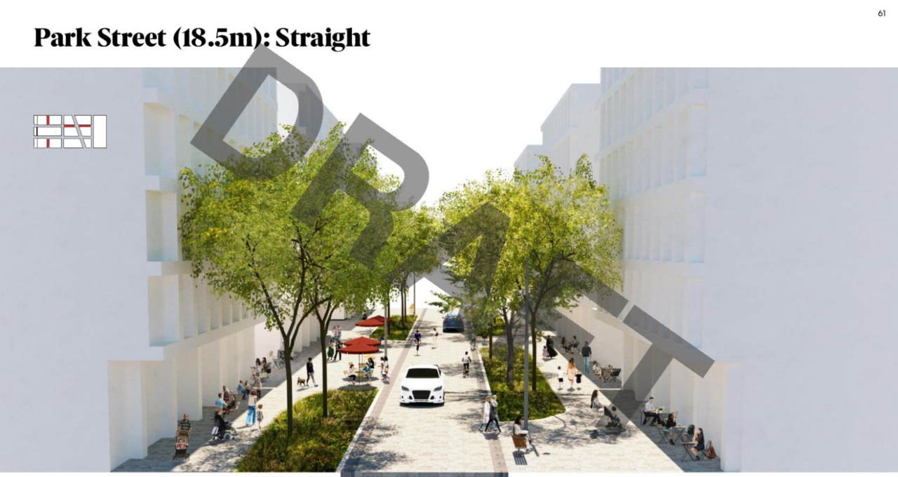

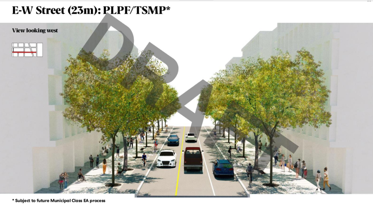

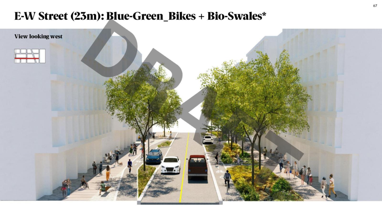

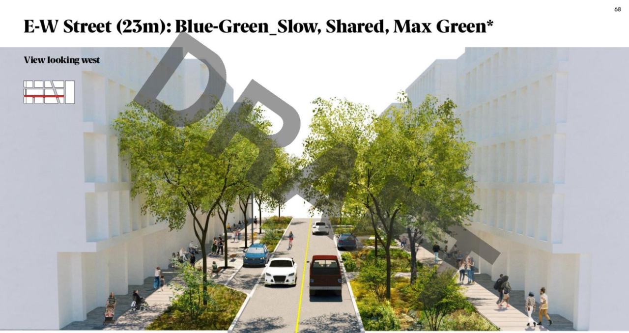

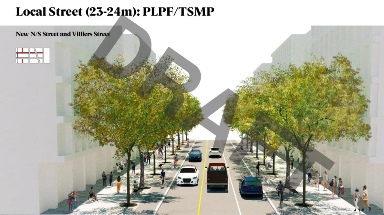

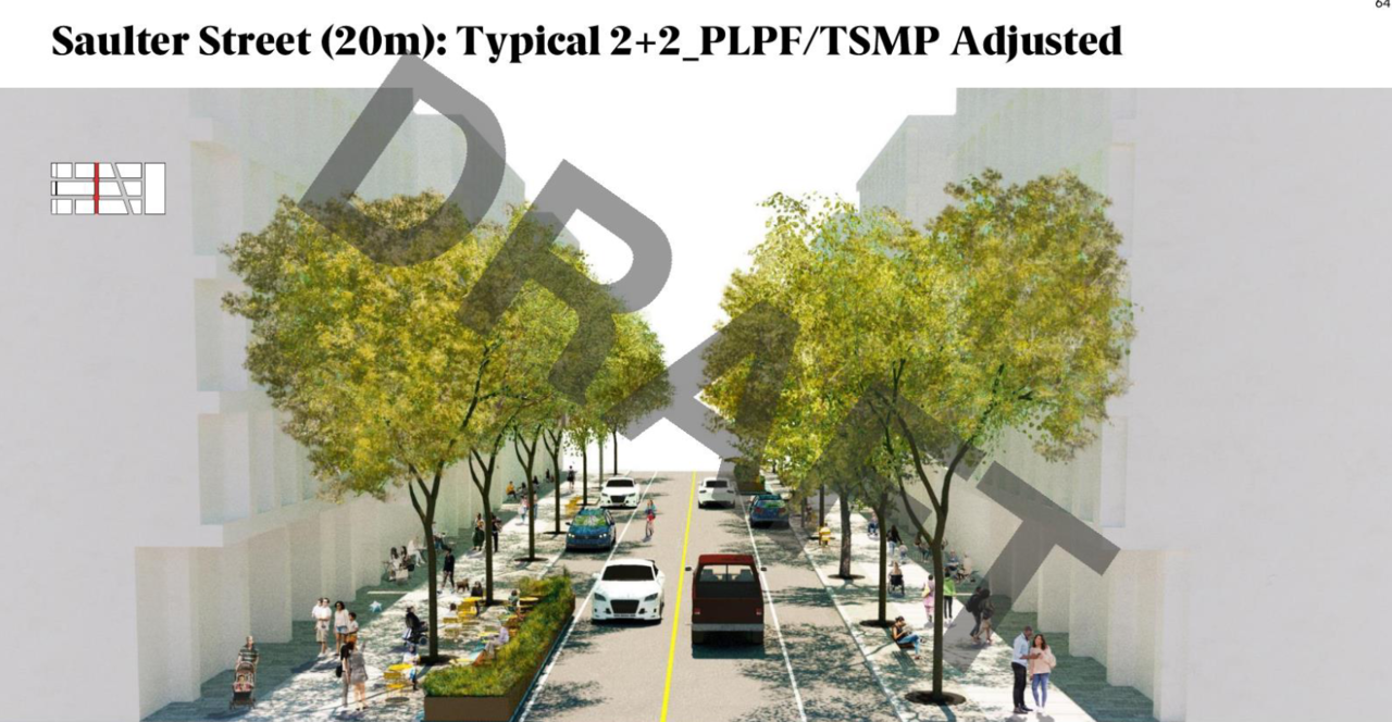

So, now lets look at the street concepts:
Ok, lets stop there for a moment for some more notes.
1) Where you see the same street in the images above, in more than one image, you should generally read the top or first image for a street as the original iteration, and the one below as the current version. In one case you will see three images for future E-W street, the first is the original and 2 and 3 represent options in the current iteration.
In this section I will comment only on the ROWs themselves and not the associated built-form.
1) The only road I'm unhappy with here on a curb to curb basis is Villliers because of the uninterrupted third (parking) lane. I do appreciate the need for some surface loading functions, pickup/drop-off etc. But I would prefer some intermittence over a continuous third lane.
2) The E-W road reads a very wide, but the bulk of that space is to allow for biowales (the landscaped area on the right of the image above which would allow the conveyance of storm water on the surface through wet-loving planting beds) We can narrow this ROW, but we would likely lose that ecological function. I"m open on this point, but we need to keep it mind as a trade-off.

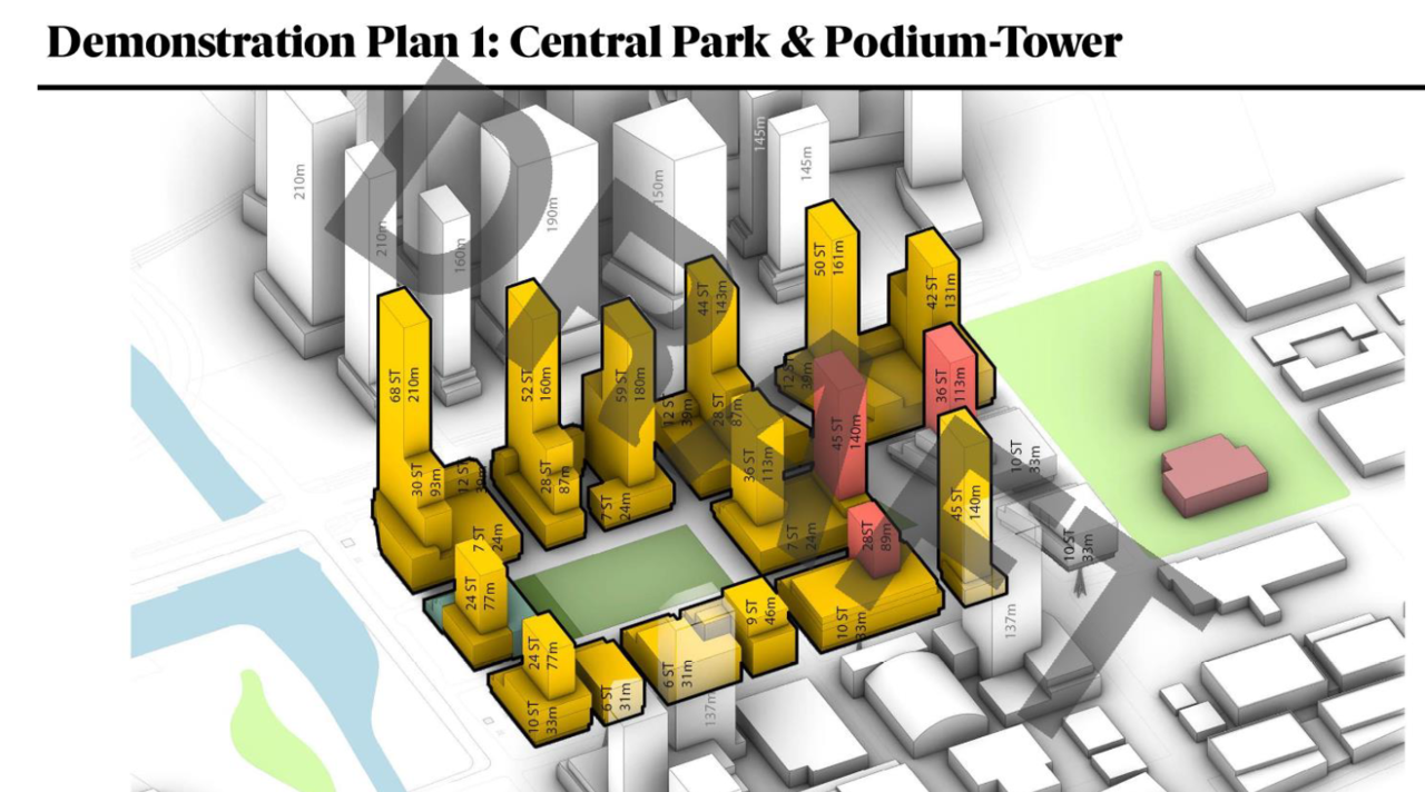

Next - Built Form.
Here I will have to ask anyone who wants to review all the options to follow the links I provided up top, because the presentation involved multiple different configurations and it would take me too long and too many posts to show them all. I will provide the Central Park based one as an example:
So, one of Alex's critiques is that he's not a fan of the tower on podium model and would like to see less of that.
I've discussed in the past why having a tower w/no podium is problematic around issues of wind and human-scale. Its not that it isn't do-able, but it requires some very specific architectural treatments to make it work.
The alternative is dense midrise and low-rise, which I'm broadly happy to favour.......but the argument advanced here is that the plan has insufficient granularity and blocks that are too large.
One important consideration here is whether you consider those mid-block pedestrian connections to divide blocks, or whether you want more 'streets' albeit fairly narrow ones.
I would argue that podiums here are already generally too high for the associated road widths, with the exception of those fronting Lakeshore and Commissioners, where greater podium heights can work due to exceptional road width and further open space.
I'm not crazy about what's above.......but I think the trade-offs here are more complex than some are inclined to admit.
For instance, we can break up the largest blocks above into to two and create a new connection or narrow road in between. But if you do so, you now have to concern yourself with having a lower building-face height against the new connection. You also need to ponder the likely wind impacts with a narrow funnel design for a pedestrian mews or the like.
Once again, this is very do-able, but its also a very big re-think and one, that I would argue slashes total density.

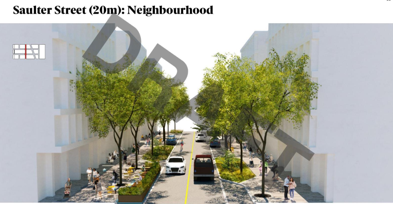

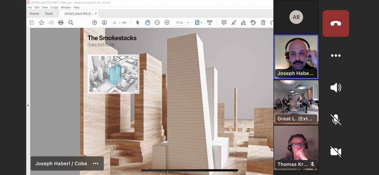

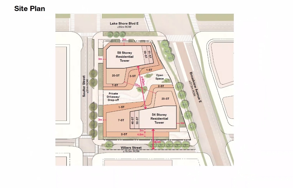

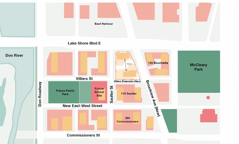

Here are three screenshots from last week’s presentations by the city, and one of the private proponents.
@Northern Light you’re correct; my piece has an error, which has now been fixed.
There are multiple interwoven problems with the urban design here.
The basic strategy has been to impose tower and podium, but allow the podium and towers to both become taller, while keeping several of the streets very wide. (Saulter remains 31m ROW.) It’s tower and podium on steroids, and all the podium of the private buildings include so-called production space, which is being shown as film studio black boxes, self storage or a Home Depot.
No part of this makes sense.
If the city is going to insist on film production related uses, which are probably not economical, those should be collected into one site and probably into one building.
loading and servicing should be integrated between buildings, reducing the presence of vehicles on the ground plane. The city has continuous ownership over 60% of this neighbourhood. Surely there is a way to make that happen at least in part.
The number of streets, and the universal presence of cars is a major strategic error. Vehicles here, as at Villiers, will need to be aggressively discouraged. It’s true that this is slightly out-of-the-way, yet it’s also walking distance to what will be one of the most important transit stations in the region. There’s the transportation strategy: walk to East Harbour. It’s not ideal, but it’s still better than 95% of the GTHA. Don’t like it? Don’t move here.
Every aspect of this project should incentivize active and mass transit and disincentive vehicle use. The urban design needs to shape the behaviour of residents, not respond to it.
Thank you.
Glad its fixed.
Agreed.
No part of this makes sense. If the city is going to insist on film production related uses, which are probably not economical, those should be collected into one site and probably into one building.
100% agreed. Saulter is excessive here. Something I would like to hear on the film issue is:
1) This is seemingly to allow outdoor location/streeter shoots. If so, how much of that activity is actually taking place within this district now (not within buildings, but outside them, in the public ROW? (point being storage of filming equipment and trailers can be done indoors, above or below grade, if that were the purpose (just parking equipment) then I would describe the use as entirely incompatible with a well designed neighbourhood.
2) While some vehicles are necessary to location shoots, were there a need/desire to accommodate for this, could any of the following be explored:
a) (Dedicated cable/conduit and power/generation for purpose within a utility conduit under the road), and/or within an adjacent building, for purpose.)
b) could a single dedicated rear-laneway be provided for purpose with parking for said vehicles, and a narrow, adjacent lane, possibly even with controlled (or controllable) access.
To your point, making multiple roads substantially wider for this use is not reasonable.
