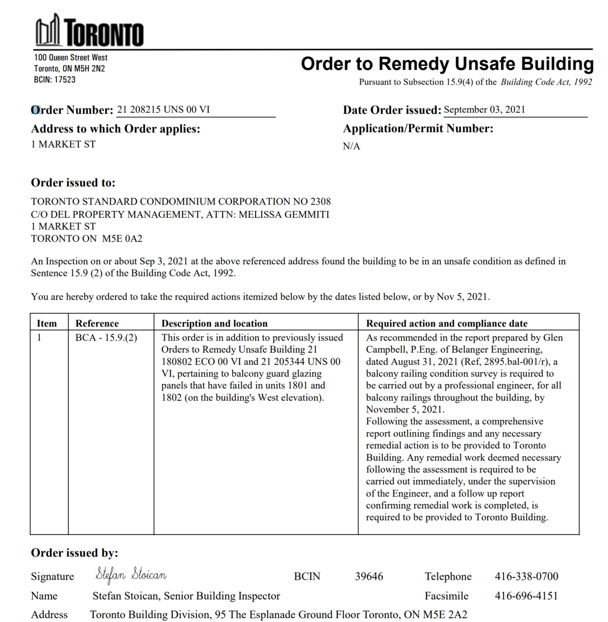

This is still noted as "Unresolved" Another example of a building that seems to be aging FAR faster than it should be!
I'm curious, when does the city inspect buildings ? i.e. under what situations ? I ask because while there has been a lot of talk about the lack of reserve fund studies in Florida they do have enforced city led inspections of buildings over 40 years, as far as I'm aware no such thing exists here ?
The requirement here in condos is for Reserve Fund Studies every 3 years (Florida had FAR laxer standards) - I do not think anyone checks these are done properly but any Owner can demand to see their buildings most recent one and can go to the Condo Authority if they see the Act is not being followed. Apart from the regular fire inspections, I think the City does not pro-actively inspect buildings; this inspection of Market Wharf was because some balcony railings 'collapsed'.
It's the insurance companies that police this: if you don't have a proper study, your rates go up up up! Theoretically this means that everyone should be keeping up-to-date with thorough studies, because which owners want to see steeper than needed hikes in their monthly maintenance just to pay for insurance?
A recent study showed that Theatre Park was experiencing concrete flaking where the balcony railings are screwed into the slab, so that's getting fixed now. No fallen glass as a result that I'm aware of. I believe the issue comes from cheaping out on the bolts as they were rusting. I expect we will see similar issues with many buildings here, most of them caught before they get serious, by the reserve fund studies.
