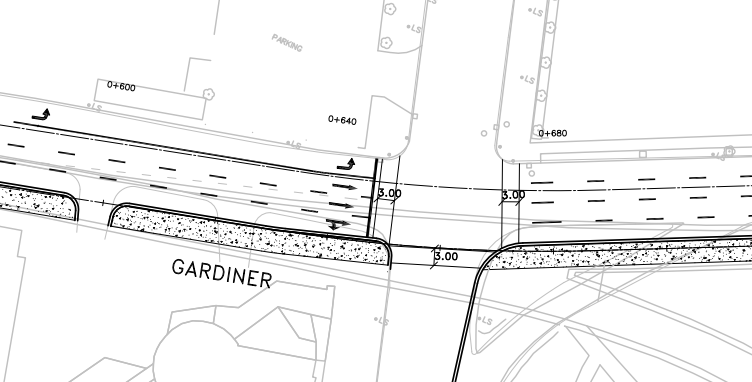

@drum118 Are you sure about it being only two straight-through at York/Harbour?
The earlier drawings showed the southmost lane being optional right-turn or straight-through. Then again these renderings also showed a jog around the column at Simcoe so anything is possible. Do you have a link to more updated drawings than these here? https://www1.toronto.ca/City Of Tor...es/York-Bay-Yonge Interchange ESR - App K.pdf
YORK & HARBOUR:
The earlier drawings showed the southmost lane being optional right-turn or straight-through. Then again these renderings also showed a jog around the column at Simcoe so anything is possible. Do you have a link to more updated drawings than these here? https://www1.toronto.ca/City Of Toronto/Policy, Planning, Finance & Administration/Public Consultation Unit/Studies/Transportation/York-Bay-Yonge/Files/York-Bay-Yonge Interchange ESR - App K.pdf
YORK & HARBOUR:
As it stands to day, there will be four lanes going east of York as noted from your posting. The future plan will see only 3 with an westbound in the north lane starting east of Yonge to York under the Lower Yonge plan and will change over time to 2.
@drum118 Sorry I lost you on the last bit, can you expand on that any?
I think @drum118 is talking about the Lower Yonge Precinct Plan. Below are graphics, although I see Harbour as being 3 EB lanes to Bay, 2 EB lanes Bay to Yonge. I don't know when/if they will reduce it to 2 EB lanes York to Bay.
