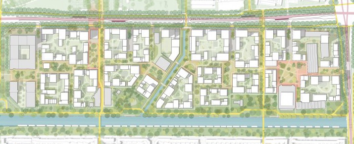

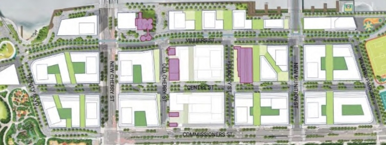

Here are drawings of Merwede (source) and the built portion of Villiers, each about 24ha. Spot the differences..

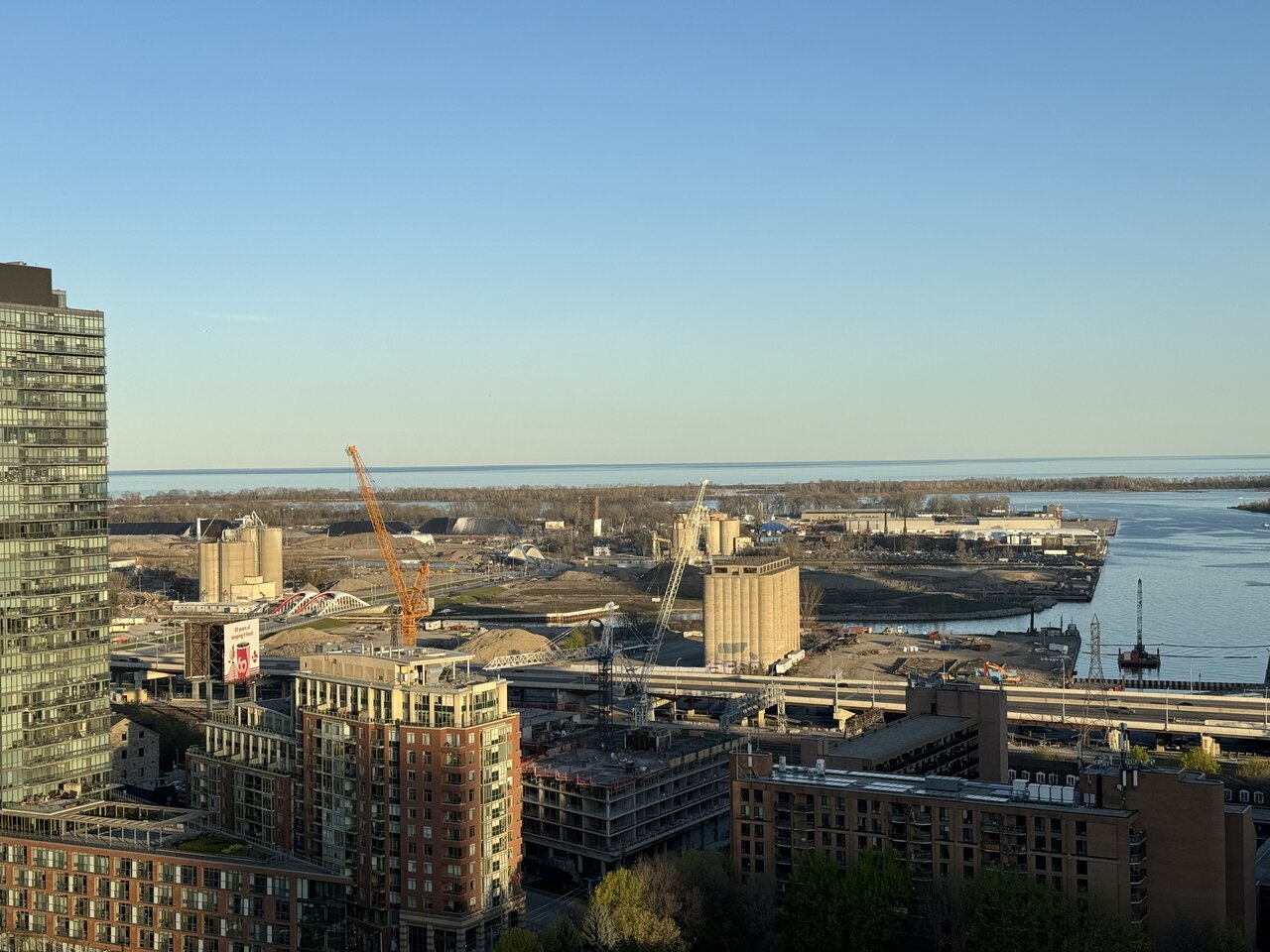

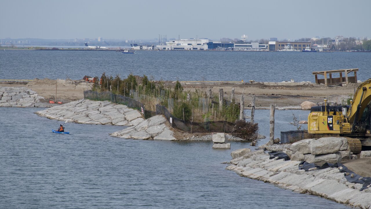

What i saw on Thursday, the removable of the north plug will happen soon.

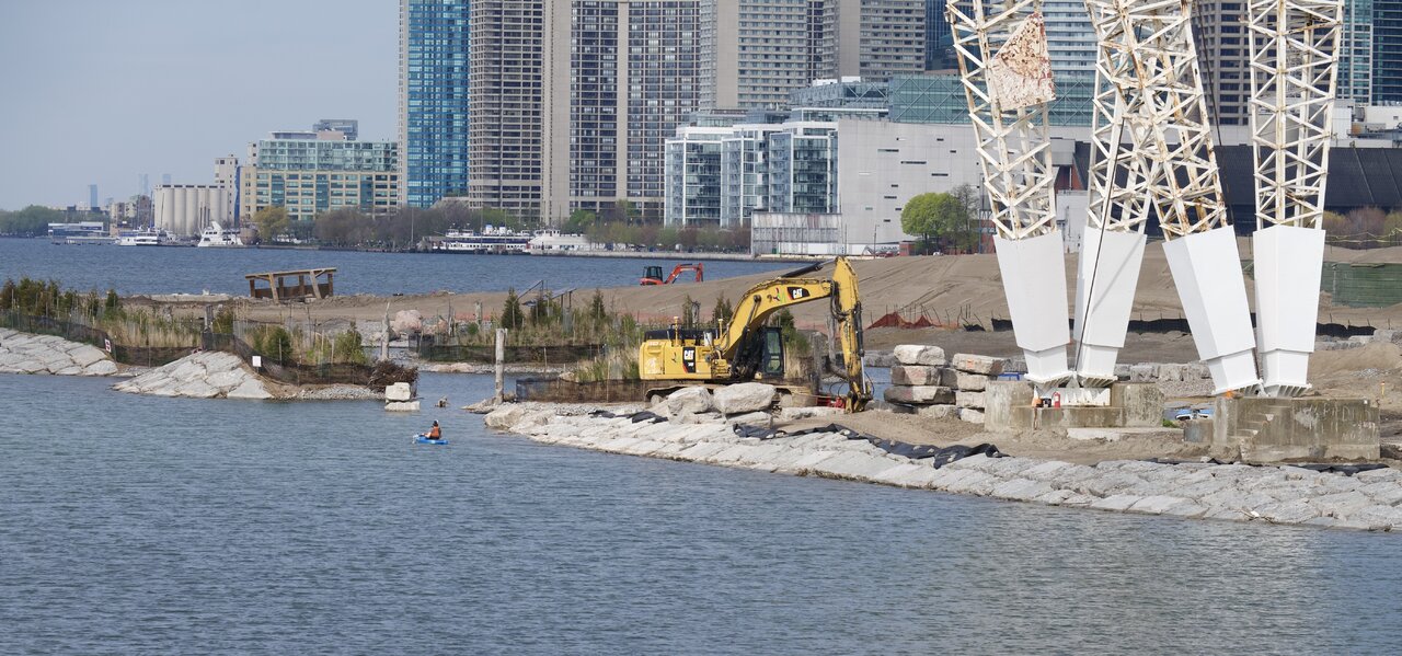

With the removal of the old Cherry St bridge, the existing break wall is still there as the break wall for the bridge was built after it in front of it. Very odd seeing no bridge there after all the years I have been around to see it.
Does anyone know if there is a break wall between the Don Estuary spillway and the Shipping Channel?
Merwede has significantly shorter buildings and significantly fewer units on its 24ha, than the 20 developable hectares at Villiers.
This, in turn allows for less parking, less traffic and less issues with shadowing in Merwede, which in part, explains the greater emphasis on pedestrian-only spaces and narrower ROWs.

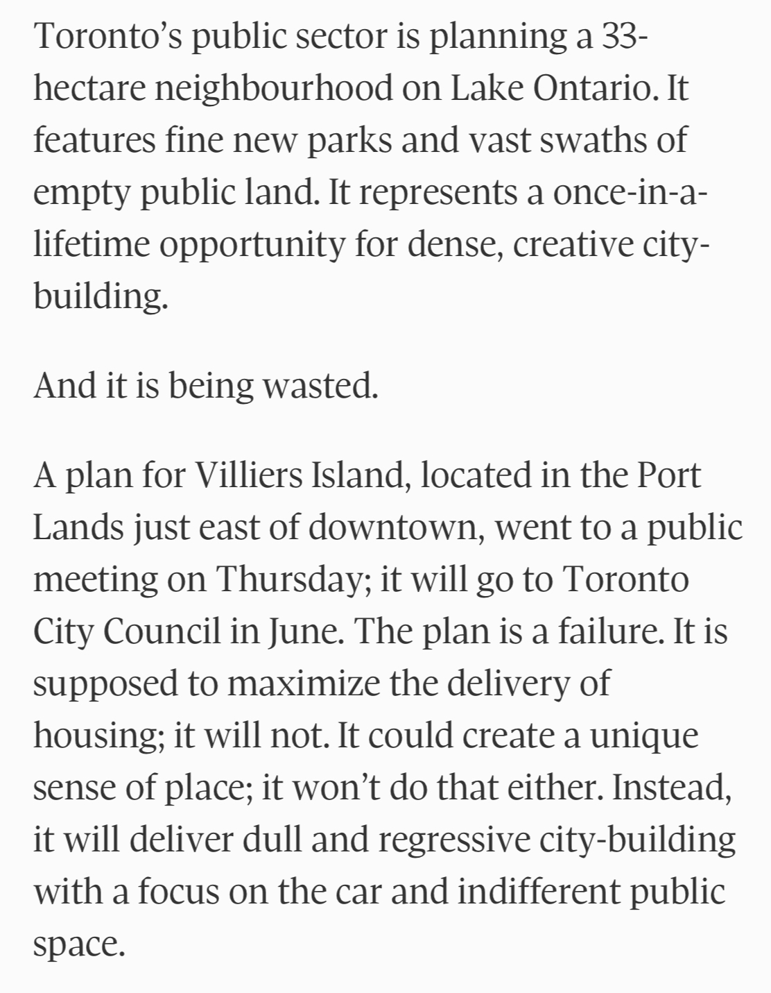

There was an opinion piece in the Globe and Mail today, an opinion piece by Alex Bozikovic, re the planning to date re the Developement of Villiers Island.
The piece was critical of the process and results so far…..
“A plan for Villiers Island, located in the Port Lands just east of downtown, went to a public meeting on Thursday; it will go to Toronto City Council in June. The plan is a failure. It is supposed to maximize the delivery of housing; it will not. It could create a unique sense of place; it won’t do that either. Instead, it will deliver dull and regressive city-building with a focus on the car and indifferent public space.”
Anyone else read this piece? The author proposes a different strategy to the planning process.”City hall should stop this train. It should call for a design competition to develop a new holistic vision for the area. Villiers should be a test case for a future Toronto: a dense city where people move by bike and transit, punctuated by lanes and squares that shun cars in favour of people.”
It’s an extensive piece with much more detail. I was interested in how UT views the proposed plan as the city has shaped it to date?
