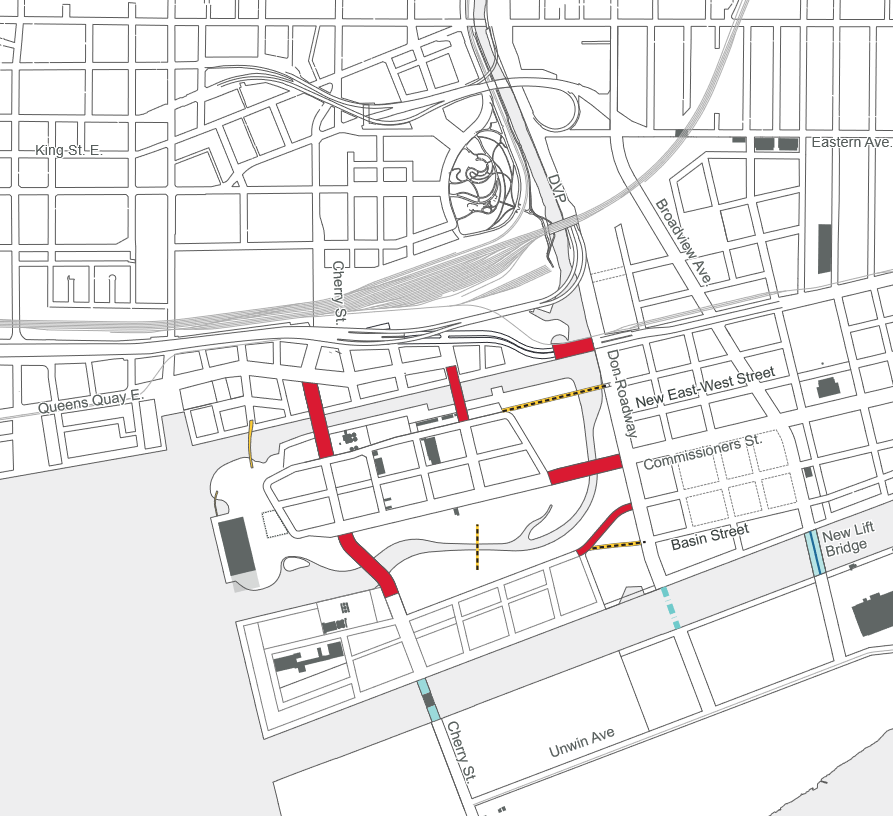

Someone can correct me and/or fill in the blanks, but the Munition Street crossing is not part of the current works. In many renderings it's the same as the rest of the new bridges, though.
The issue is that there is nowhere good to connect it to on the other side yet, and major reconstruction of the Gardiner is planned in that area so there's really no point in building a bridge that won't be usable for years and may not even be needed.

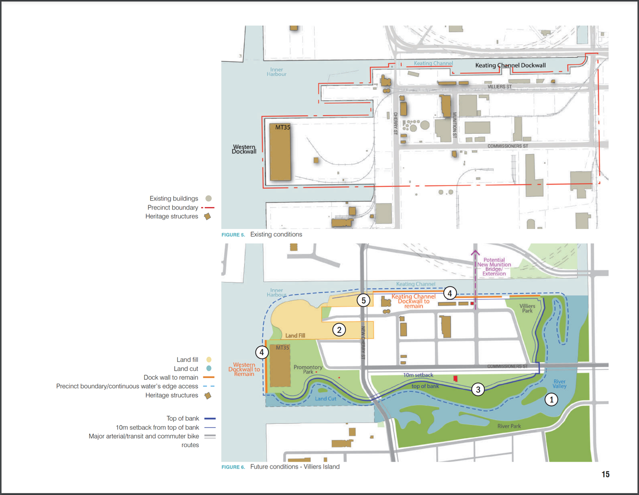

There are no discussions I can see of there EVER being a Munition Street bridge. See: https://portlandsto.ca/wp-content/uploads/June262019WTDRP_PLFPRoadsDetailedDesign-watermarked.pdf
and this from 2017: https://portlandsto.ca/wp-content/u...rs+Island+Precinct+Plan+AODA+Attachment+2.pdf
There is no Munition Street bridge that will ever cross the new river valley but the very image you posted shows that there will be one across the Keating Channel; or at least one was planned for....

The Keating Channel crossing is the one being referred to, not a bridge across the new river valley

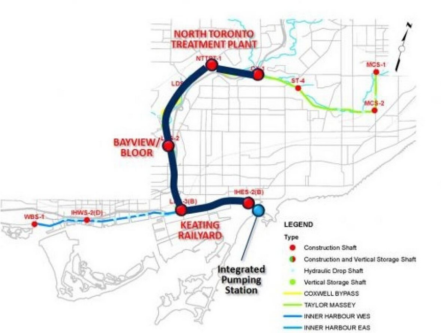

The work is already planned, @DSC was merely noting it will be awhile before it's complete.
Once the current Coxwell bypass and associated works are complete there's still the Taylor-Massey tunnel and an additional tunnel along the central waterfront to capture all those outfalls.
Even once that is done, there will still be Combined Sewer overflow into the Don from multiple sources, though vastly less than is the case today.
