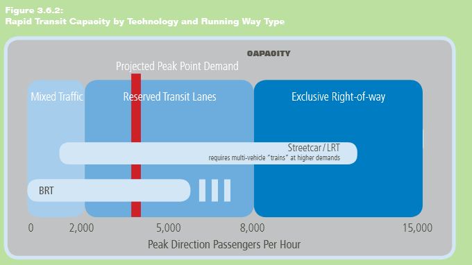

There was a discussion about this in the "Tim Hudak's plans" thread and I had asked a question but not sure it was answered....was trying to understand the ridership projections in this document.
http://lrt-mississauga.brampton.ca/.../Master-Plan/hurontario_MP_Part1_Chapter3.pdf
On page 98 (pg 28 of pdf) this chart appears which (if I read it correctly) shows the peak demand can be comfortably met by LRT (and can actually be met by BRT).
What I wondered in the other discussion was if that peak demand was driven, in part, by the assumptions in this chart:
I find some of those assumptions a bit hard to swallow (if I am reading it correctly). For example, Brampton GO - Steeles (southbound) currently sees transit getting 8.4% of the traffic but that leaps (in the base LRT case) to 71.1%? Similarly, Burnhamthorpe to Dundas goes from 11.8% to 64.8%?
Again, I am not sure if I am reading these right (and don't mind being shown how I am not) but if the ridership projections at that peak level are served by, either, BRT or LRT and that those projections themselves are based on such massive jumps in transit utilization....I have a hard time believing them.

Maybe I am asking the wrong question the wrong way. ...I dunno.
Focusing on that Brampton GO to Steeles. What that chart says to me is that right now, with an upgraded bus line, of the people making that journey 8.4% choose to do so via transit. Replace that bus with a LRT and the number changes to 71.1%?
That just does not ring true to me at all.
EDIT: to accept that number we would have to accept that for every 1 person on one of those Zum buses now there are 8 - 9 saying, "hell no, but if it were a LRT I would".
Well according to that, Hurontario is theoretically well within in the limit of BRT capacity as well. But there are many different implementation of BRT, including full grade separation like the Mississauga Transitway. BRT as it could be implemented on Hurontario can not handle the projected ridership without causing major interference to other traffic.
Likewise the projected ridership for Hurontario-Main LRT, approaches the practical limit for LRT as LRT could be implemented along Hurontario. They could add a third LRV to the trains (and based on the ridership projections, the report says Hurontario will need 3-car trains by 2031), but the report states that parts of Hurontario have no room even for stations that can handle 3-car trains, let alone 4-car or more trains.

Hurontario-Main has a projected annual ridership of 29 million, Eglinton Crosstown 53 million. Peak point demand of 3400 vs 5000. It's not a world of difference.
I guess that brings us back to those ridership projections that I am really struggling with.
