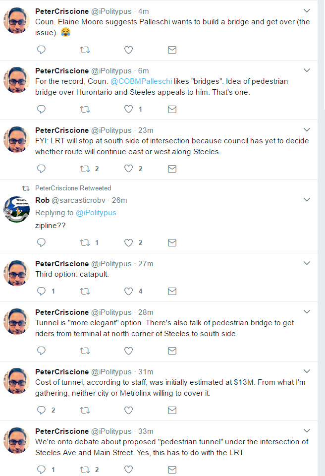

Brampton Council discussing some LRT related business today:
Just for context, here are the Brampton staff recommendations which were adopted without amendments. Full report is one page 204 of the PDF here.
2uLKGuu
So Brampton is looking at a $13MM tunnel and saying $1.4MM is for sure there from the LRT budget.... have requested (but not received confirmation that they'll get it) $4MM refund on the EA...and that would be the city's contribution towards the tunnel? So the tunnel is subject to ML saying "sure, we will put $8.6MM into the tunnel on top of agreeing to give you $4MM back on the EA?
So, Brampton is trying to get the tunnel for free.
One idea I had was not build the tunnel....but, instead, build scramble crossings from each of the 4 corners at Hurontario and Steeles.....the scramble crossing would be activated by the LRT in the station....so when an LRT "flipped the switch" all vehicles would be on a red (full red...no turns allowed) and anyone at any corner would be given a 90 second (or whatever time was deemed appropriate given distance) to cross to or from the LRT......sure would be cheaper and would make the crossing as safe as a tunnel would.
