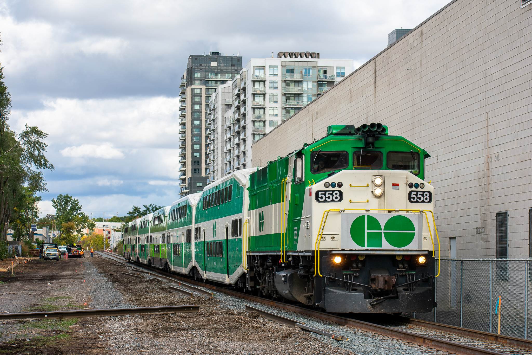

Railway diversion, part of Davenport Diamond Grade Separation Project - car on Wallace
by Jeremy Gilbert, on Flickr
View from Dundas, as you look going up the tracks, the bridge over Bloor at the expansion joint is visible, then the tracks veer to the right to allow construction of the elevated Guideway, then the tracks meet the level crossing at Wallace where the car is, continue over Davenport, its expansion joint barely visible near the top, finally intersecting the CP line at the so-called Davenport Diamond, before veering to the left in the distance.
Love this perspective-crushing telephoto shot by Jeremy Gilbert.
