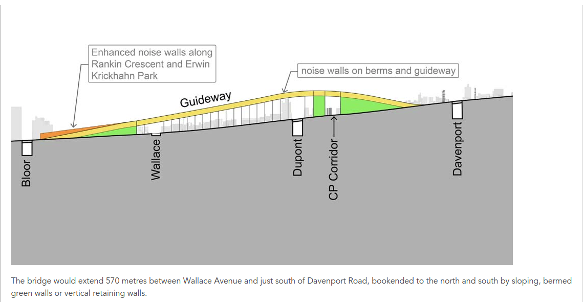

Doubling the diamond is an interesting idea, but it would be prohibitively expensive
I don't follow your logic.
Perhaps we're not talking the same thing:
From Wikimedia Commons, the free media repository
https://en.m.wikipedia.org/wiki/Level_junction
Also the flyover is planned to be for double track, but just one track used for now. I completely dispute your costing assumptions, but it might or must be based on a misunderstanding on either your or my part. The bridges are all in place and in good shape from what I can tell (equivalent shape to others on the Metrolinx network) albeit they need some TLC in spots as do many others.
As for pathings, if the intersecting traffic is blocked for the lateral direction of movement, bidirectional traffic across the junction through the same window can utilize the existing traffic sensors and only a slightly increased circuitry as for one track at present. Ford can state: "We've doubled throughput within the same window being used now". Technically he'd be correct although to achieve that would require coordinated train control schedule and operation.
There is one massive problem, which in fact plays into the present QP regime's playbook: Catenary. CP won't allow it to cross their track. It's not their legal decision to make, but the CTC will agree with them on this. And Ford, Fedelli and Foolishness will rejoice together. There's absolutely no sign of electrification on the horizon.
"For the People, we've stopped the intrusion of Davenport Flyover Liberal Fiasco, and with our partners at CP, found a much better solution and saved taxpayers at least $250M, and put an end to the division of neighbourhoods, electric interference and the scourge of progress".
Sound ridiculous? It is...but that's exactly what they did with the K/W line and CN. Ford will claim that a 'simpler and cheaper double tracking arrangement is even more effective for increasing GO service than a single tracked flyover'. Whether that's true or not matters little to the F Bros. And the gullible masses will accept it, as many have for the K/W line without the "Agreement in Principle". Remember that folks? It had a lot of you fooled.

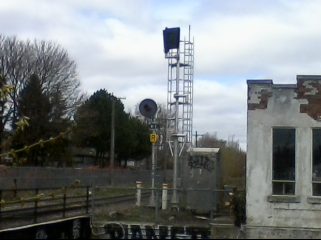

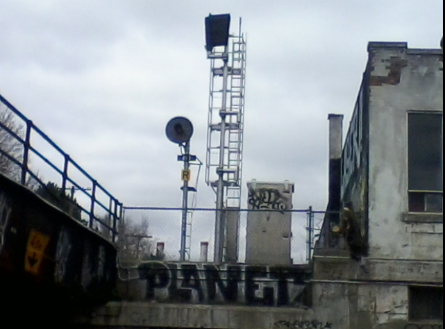

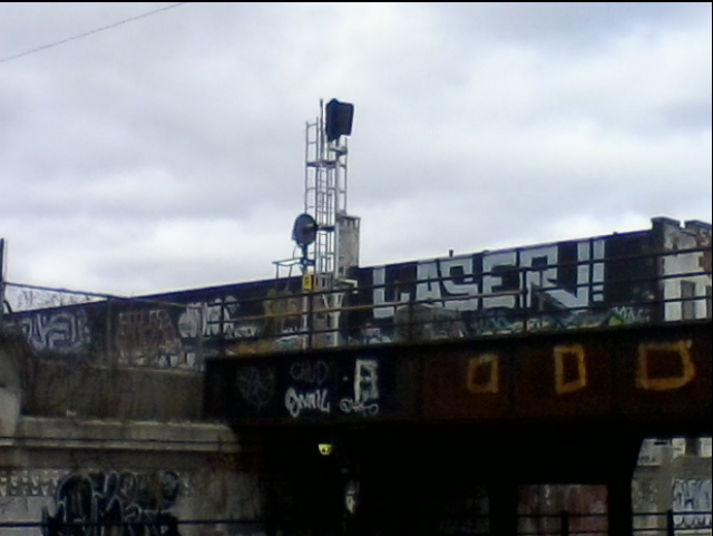

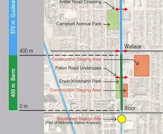

So tell me, why would Metrolinx install the signal mast they have at that location when it's going to have to be moved again? It doesn't make sense with what they're stating. Some of what I posted was a couple of years old. The latter two pics were from their latest report, just released a few months back.

- Construction of a rail guideway offset within the corridor during construction to accommodate a temporary diversion track and a temporary rail diamond;
That lends itself to at least two scenarios...one being Bait and Switch.
And, it would have to be a couple miles long anyways - just as expensive and just as intrusive as the flyover. And CP is expecting that the conflict of the diamond will be eliminated, not maintained. And that would guarantee that ML would never be able to restart the flyover at a later date, given legalities and community opposition etc. I bet they would prefer to do nothing than go backwards.
Evidently not. They'd prefer to do the 'preliminaries' and then kick it down the road, which is exactly where my point started. They'd have to have two diamonds operating along with two tracks before ripping up the original. End of Phase 1.

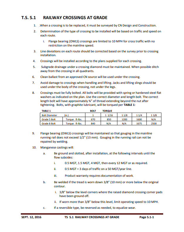

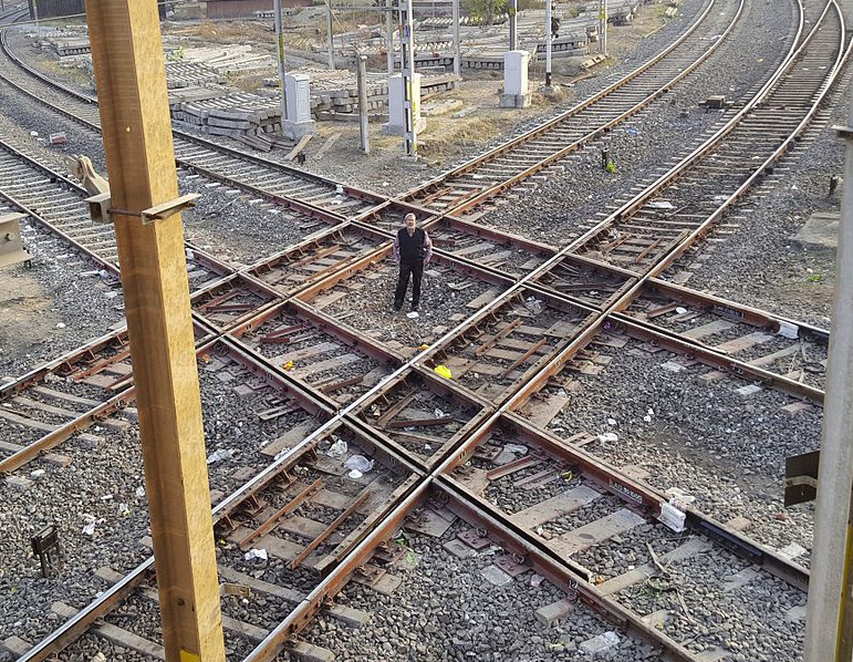

As a complete aside, note the Indian Railways double diamond, and the lack of flange notches at the rail intersections. That's a low-noise design, where the railheads of the lesser used line are bevelled down to the intersection, and the wheel flange is taken over the junction on its edge, rather than the wheel surface. I'll see if I can find a reference for that. I'm skeptical of the amount of wear and stress they put on the flanges, but many railways use them. One wonders if such would be possible at Davenport? Non-standard flange reach might be an engineering challenge though.
Indeed:
A one-way, low-speed (OWLS) diamond in
Champaign, Illinois. This is an example of flange-bearing frogs in use on North American freight rail lines.
https://en.wikipedia.org/wiki/Flange-bearing_frog
See:
Needless to say, Ford could do this and then claim: "We've fixed the noise problem and saved close to half a billion dollars doing it My Friends".
