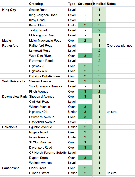

Is there room in the corridor for a third track? I find it hard to believe that they can even fit a second track as it is.
There are a number of places where a third track would be a challenge because the existing structures only support 2 tracks and it would be a big job to expand them. Some examples are replacing the Eglinton Avenue bridge or expanding the Snider Junction flyover for the CN York Sub. But building the second track would be a breeze, there's plenty of space and most of the infrastructure is already there to support it. All structures south of Aurora, except the Yonge Street overpass, are built for at least two tracks, with many built for three, such as the new bridge over the Don River south of Langstaff, completed last year:

Here's a quick aerial overview I did of the structures along the southern Barrie Line:

I think the most likely segment to be triple-tracked would be from just north of Sheppard / Downsview Park station (which was designed for 3 tracks) to just north of Eglinton / Caledonia Station (which is being designed for 2 tracks). This would allow peak-direction local trains to pull off to the side at Downsview Park station to be overtaken by express trains. Meanwhile counter-peak service would be infrequent enough that express and local services could coexist without overtaking along the line.

I am sure I saw a ML document on line recently that did mention (in very terse language) that the third track was not forgotten, although it is not a current spending priority. Two tracks will fit just fine through Davenport, but a third track would consume the full width and likely remove any open space that this plan creates. I doubt ML will draw attention to this potential while the residents are still digesting the 2-track plan. It may not happen until mid 2030s anyways.
There are a number of places where a third track would be a challenge, such as at Eglinton or the CN York Sub (Snider Junction) where existing structures only support 2 tracks and it would be a big job to expand them. But building the second track would be a breeze, there's plenty of space and most of the infrastructure is already there to support it. All structures south of Aurora, except the Yonge Street overpass, are built for at least two tracks, with many built for three, such as the new bridge over the Don River south of Langstaff, completed last year:
Image of new Don Valley bridge from October 2016
Most of the line is more than wide enough for 3 tracks. Check the Barrie Rail Corridor Expansion, Caledonia GO Station and Davenport Grade Separation EAs to see just how much room there is along there. Hell, when most of the stations get rebuilt as part of the double-tracking, they will be spaced out to allow a future third track to be placed right down the middle between the first two mains - just like the bridge over the West Don River.

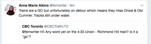

Detour is likely up the Newmarket to Snider, then a reverse move similar to VIA's Canadian, then east to Doncaster and north.
I wonder if ML has considered this scenario in their promise to Davenport residents to only run x trains per day once the overpass is finished. Is there a caveat about "under normal conditions"?
At any rate, I doubt that's a legally binding commitment, and even if it were, I would imagine that depending on the wording a judge would be very likely to recognize that emergencies happen.
The issue isn't how does it play in court, it's whether an agency like ML can give its word and stick to it. Or be transparent about its true intent ahead of time.
I suspect the residents wouldn't care about rare unusual events... they care about the normal schedule. Winning in court is not necessarily honourable. Offering full disclosure beforehand is. It's about trust.
