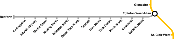

The initial phase of the Eglinton West Line would have terminated at Mt Dennis. The ridership on this line would have been extraordinarily low, which would have been detrimental to any advocacy for expansion.
A western expansion could've been built as subway, LRT or BRT. AM peak hour ridership eastbound into Eglinton West-Allen Station was expected to be 7,700 pphpd for the Crosstown LRT, which is rather tepid for a subway line (I expect the Eglinton West Subway would have similar demand). The debate would have been rather similar to the Sheppard East subway extension debate, with some using the low ridership of the subway to push for LRT or BRT, and others pushing for a subway extension regardless of ridership. At the end, I anticipate that it would have been extended west as a surface subway line to Kipling or Martin Grove.
The situation with an eastern extension would be quite a bit more complicated. I suppose it would have probably played out one of two ways:
  1. A proposal to extend the subway underground east to either Yonge or Don Mills. The ridership potential of both of these proposals would be low due to the abrupt termination of the line, making advocacy for this extension more challenging
  2. A proposal to extended the subway east to Kennedy. Ridership would be very high, but so would the costs. Yonge Line crowding would be getting critical, potentially making any eastern extension of the Eglinton subway not feasible. And even if the extension were still technically possible, it would have to compete with the DRL and SRT replacement for funding. The DRL and SRT replacement are both far more critical projects, through a purely objective analysis
Neither of these options are particularly palatable, so I'd say that it's most probable that the Eglinton West subway would not have been extended east of Allen to the date. An extension west to Kipling/Martin Grove would've been the only extension for quite some time. Perhaps the matter would be revisited after the completion of the DRL to Eglinton.
