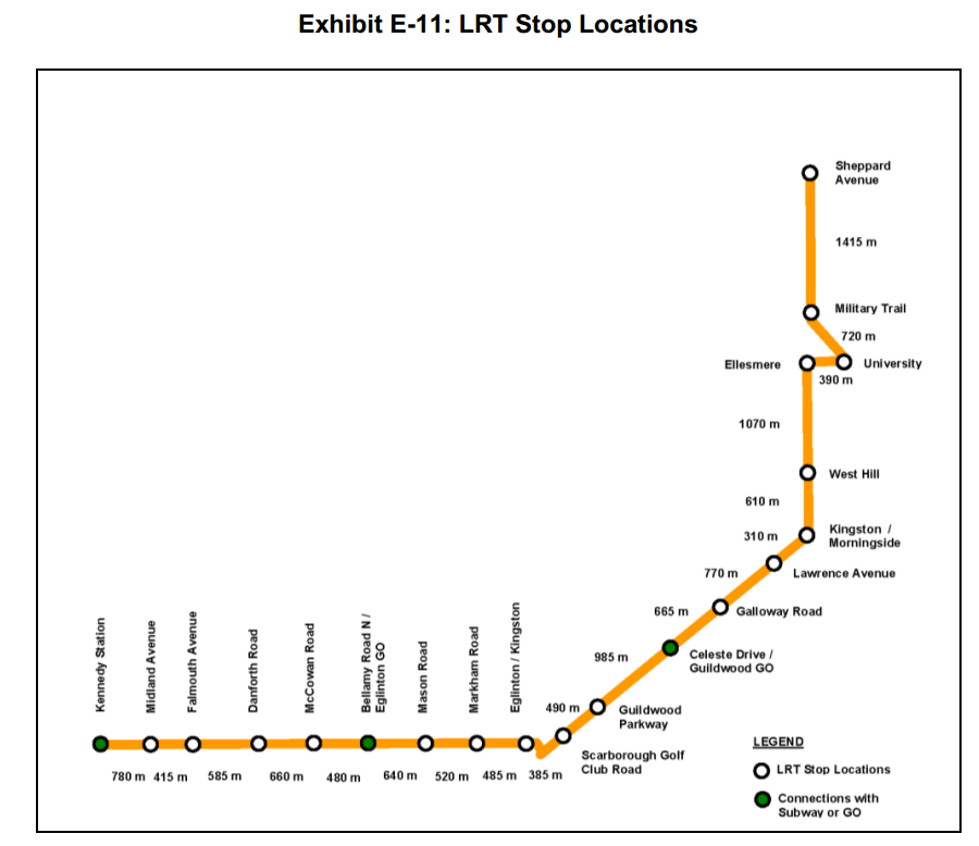

What does fewer stops and more grade separation on Crosstown East look like? How can it become closer to a higher-degree of rapid transit in nature?
Before answering, it might be useful to take a look at the stop-space between proposed stops in Crosstown East route. Scarborough is sort-of a big place.
Would removing a stop or two necesarially improve operating speeds along the route? I'm doubtful.
I don't know what it is about this route that make people keep on calling for wide stop spacing, there's no reason for it, even just eliminating the two closest gaps would leave spacing of well over 800m.

There's very valid reason if half of these stops will be very sparsely used. Do any of you even venture through east Scarborough on a regular basis to know what I'm talking about, or are you just armchair critics?
Run a parallel bus if you think these intermediate stops are so vital to be served by a billion+ dollar rapid transit line. It's no wonder the line is in jeopardy.
And the central portion of the Crosstown Line does have 800 metre apart spacing through a far more densely populated area of the City. Is it too much to ask for someone to get from UTSC to Kennedy in 12 minutes versus 24? Time savings are indispensable.
I've mentioned it in the forum before how to go about about fewer stops.
1. Consolidate some of the stops. Instead of Midland and Famouth, a single stop in the block from Commonwealth to Huntington. Combine Mason and Markham. Combine Kingston/Eglinton and Golf Club. Combine Lawrence and Kingston/Morningside. There you go. 4 highly trafficked stops versus 8 poorer performing ones.
2. Cut the West Hill stop. 116 bus covers this already.
3. 3 stops at UTSC is a bit much. A single underground station on the campus proper, followed by the secondary terminus at Military Trail/Morningside would be better IMO.
I've just taken 18 stops and turned it into 12. And the walking distances aren't vastly affected either. How am I the bad guy for suggesting a leaner, more efficient, more bang for our buck LRT line? If you think about it, I'm not really suggesting to cut anything.
As for grade separation. Again this has been covered previously. Grade-separate at Brimley/Danforth Rd, Bellamy/Eglinton GO, Kingston/Eglinton, Guildwood GO, West Hill triangle, separate bridge crossing at Morningside Park/Highland Creek, UTSC campus, separate 401 bridge crossing if ever extended into Malvern.
