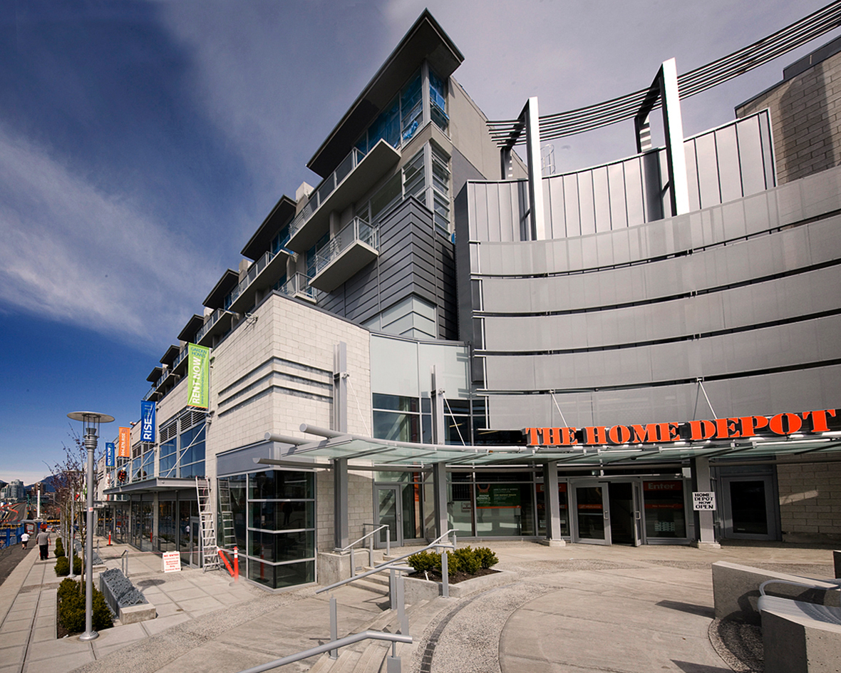

There's a series of vents like that outside the project called The Rise on Cambie in Vancouver - but much more jagged:
http://c767204.r4.cf2.rackcdn.com/d99d480c-bd47-4684-a3ee-928001ecc407.jpg
