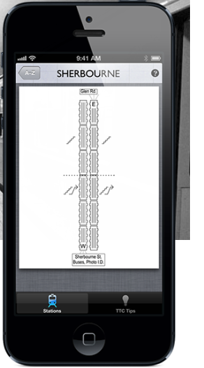

When will they update the "Efficient TTC" smartphone app? See https://efficientttc.weebly.com/
on your subway rides! EFFICIENT TTC shows you which subway car doors are near which escalators and stairs. Never be caught at the wrong end of the station again!
I don't see Line 5 nor Line 6 on the app. Still showing "Eglinton West" instead of "Cedarvale". Shows Version 1.3 from 3 years ago.
Unless there is a newer or better app somewhere?
