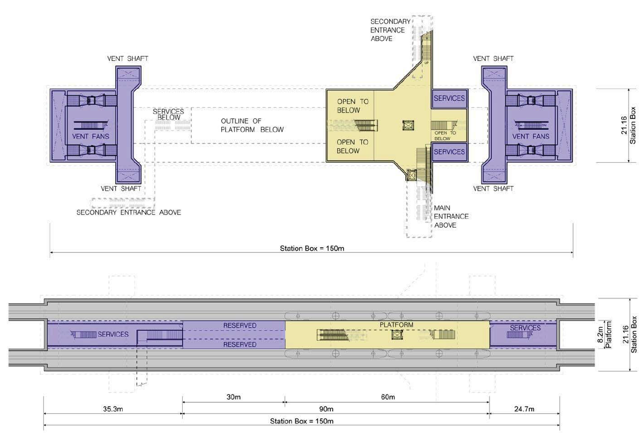

The underground stations can just squeeze in 4 car low floor LRT trains with some demolition of false walls and structures at each ends of the platforms.
Ontop of that, custom low floor LRT's could be bought that are all one long train with many modules, adding capacity.

From earlier in this thread, see link...
From PDF at this link.
Absolutely. The full space we have to work with is about 150m. Plenty of room.
You could have a train built out of 2 Alstom Citadis Spirit 5 module 59m cars (these are even bigger than the Ottawa ones) and a middle 3 module 30m car. For a total length of 150m and a passenger crush load capacity of 930 people. Almost 1000 people per train.
