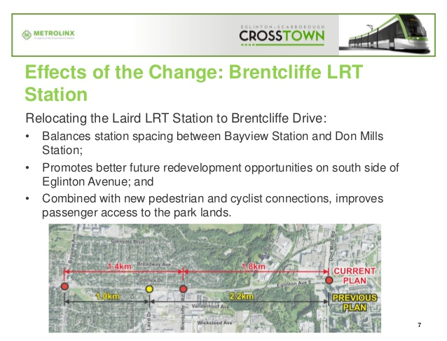

That aside... not mentioned at all in this discussion is that Metrolinx pushed to have the section between Laird and Don Mills changed to a bored tunnel beneath the Don Valley, with the Leslie and Ferrand Dr stops eliminated. They may have considered other surface options, but those were rejected in favor of a tunnel. Of course the documents have since been deleted as per Metrolinx's usual contempt for transparency, however I managed to pull a few slides from the deep web from a public consultation.
They did not consider any options. They said due to slope stability problems, it was imposible to put the Brentcliffe portal in the original EA approved location, so they proposed tunneling all the way to Don Mills. When locals complained about losing the Leslie stop, they said that station (underground, but deep) would cost $60M and that was too much. I don't recall any complaints about losing the Ferrand stop - which was the correct reaction. Then when the public was still unhappy, they reverted to the "impossible" original EA Brentcliffe portal and routing through Leslie.
View attachment 198205 View attachment 198206 View attachment 198207 View attachment 198208
One of the slides in my post suggests that there was enough pushback that Metrolinx later added it back to their tunnel proposal.
