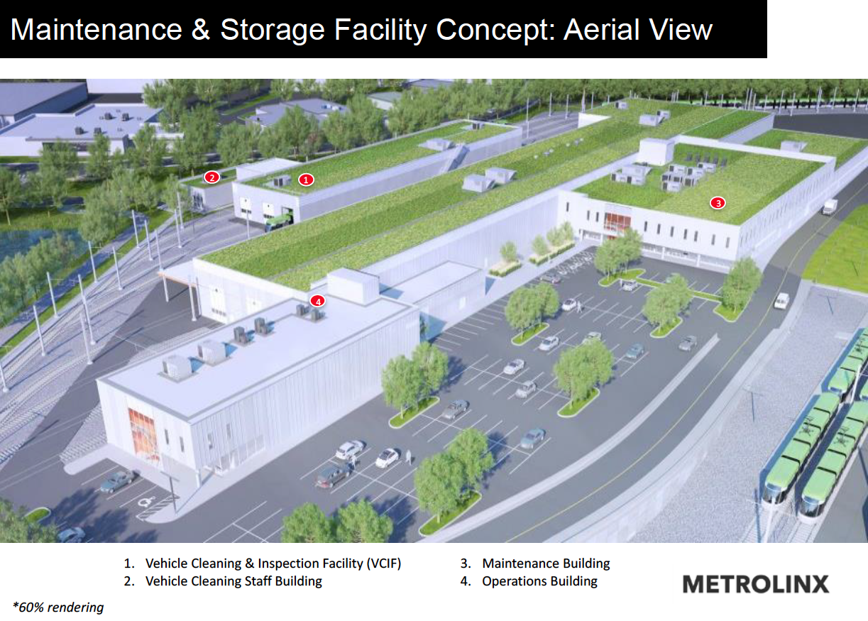

Couldn't they put solar panels and wind turbines in or around or on the MSF?
Not sure about wind turbines, they may be noisy and will look weird in the urban surroundings.
Solar panels, definitely yes. They are getting cheaper, and have no negative effects at all.
Besides, in a blackout, if the purpose of the gas plant was to provide power to allow trains to run, was it also going to be providing lights around the whole area along the crosstown to allow drivers to see where they are going?
