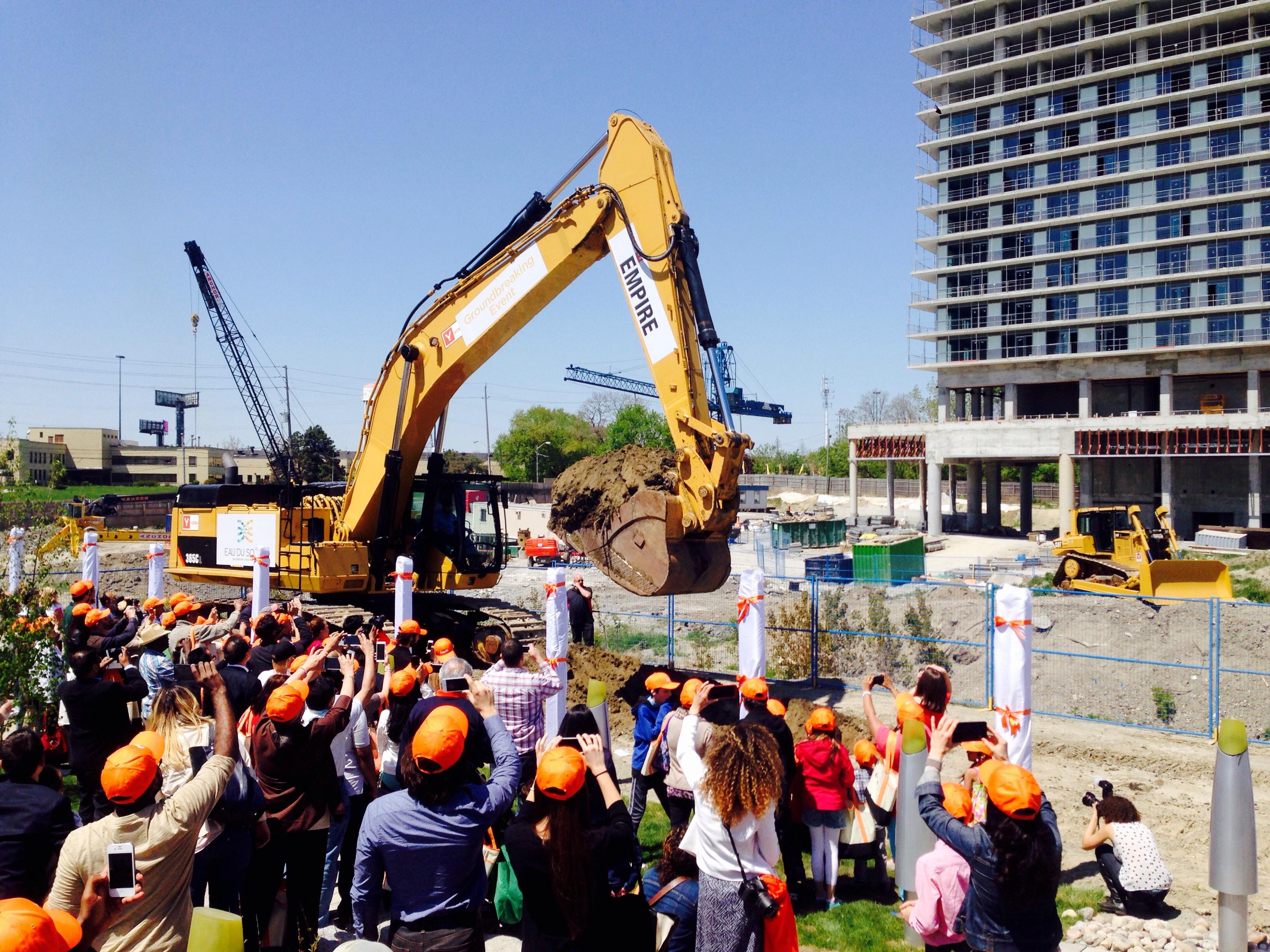

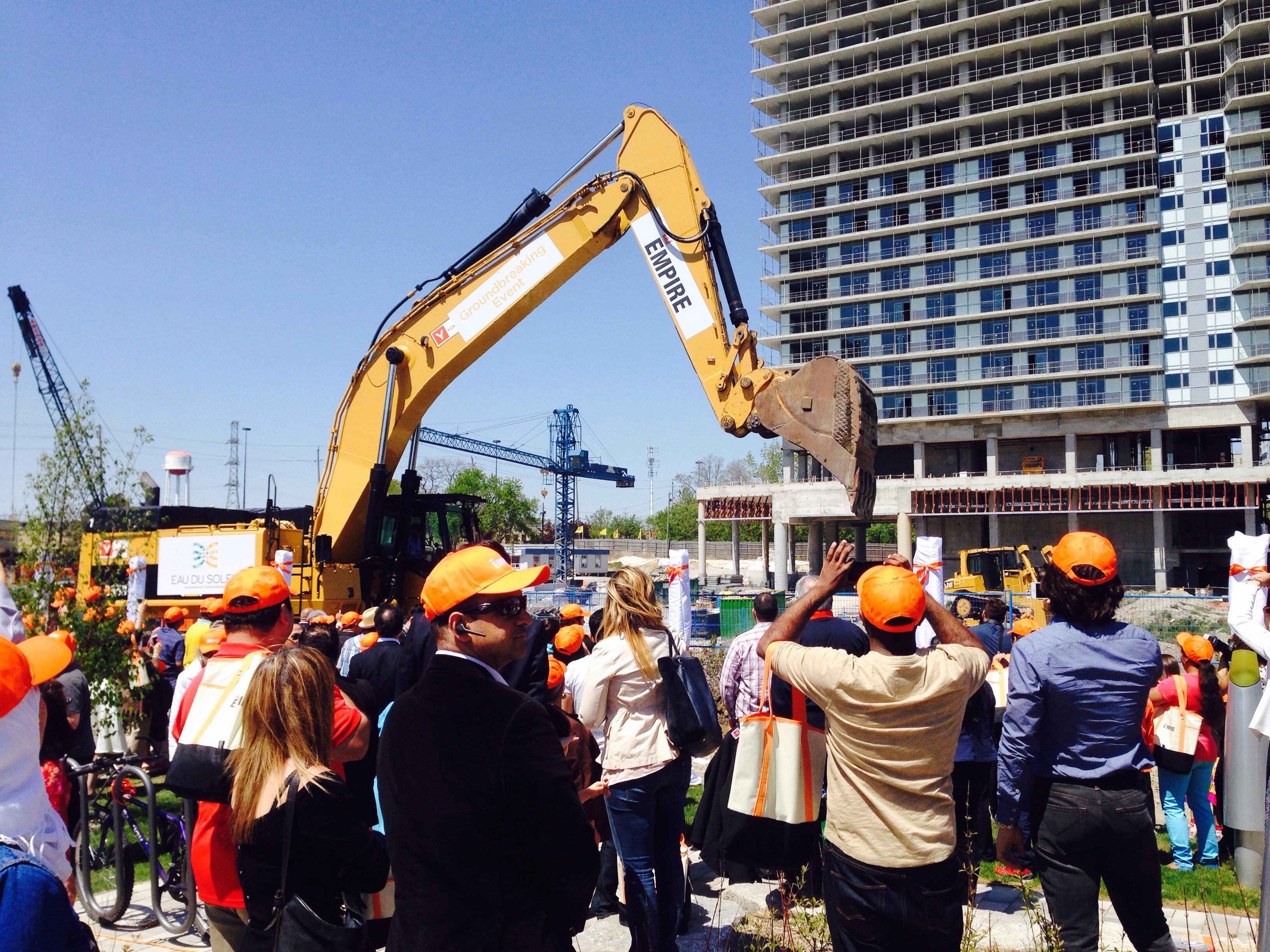

Did the scheduled official ground breaking actually take place?
Secondly, when there is a request for a variance, as is the case here, how soon after the hearing is the decision typically announced? Thanks in advance.
It happened yesterday.
attachment.php
attachment.php

On June 6th.
