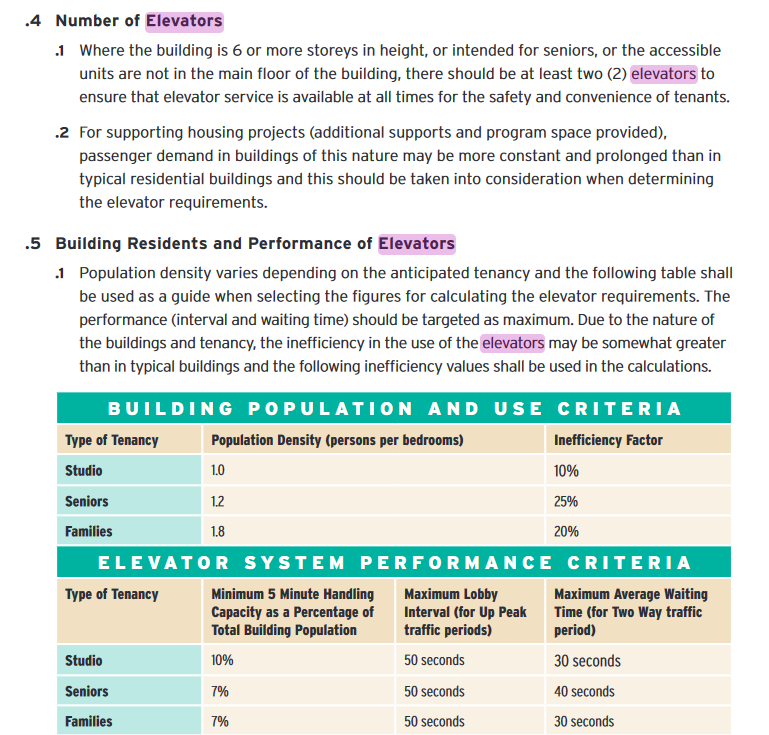

BC Housing has a set of standards:
Having scanned a raft of sites; the consistent elevators per unit range is 60-90 per elevator.
A small number of government and elevator-related resources use performance standards as shown above, and some also use a per ft2 calculation, presumably as a proxy for total population demand.
I think population demand is key, both in total numbers and in composition.
One has to know what percentage of residents are likely to need an elevator at the same time (school/work); and how many total residents.

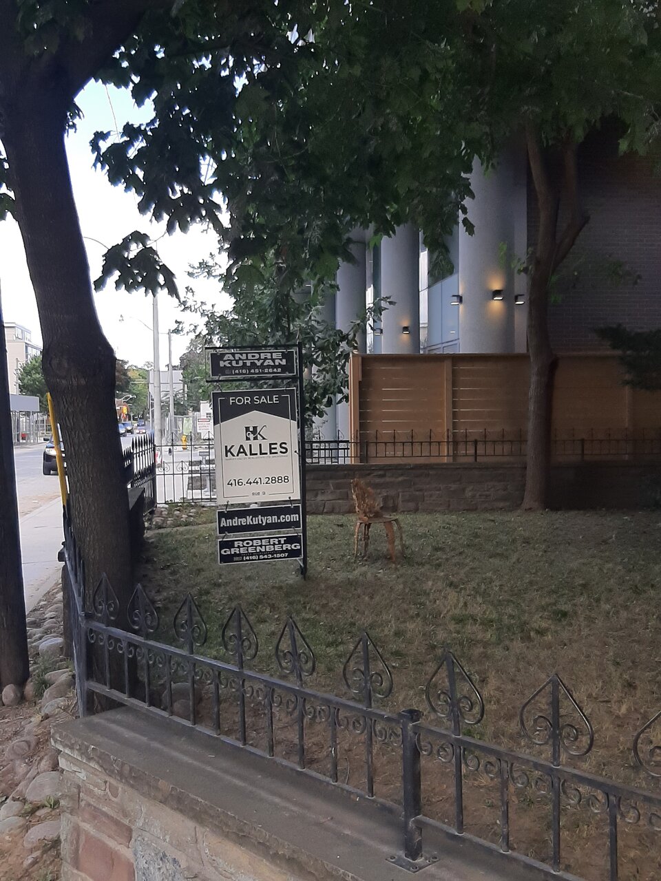

Holdout property sold for $2.65m, over a million more than asking. The listing pushed a) parkland possibility and b) possibility of 4-storey apartment building. Curious who bought it and what it will be used for.
Yep. I took this after I saw your reply in this thread.
How sad does this look.....🤦
The grass used to be nice and green now it's lacking any sunlight well duh the neighbouring 34-storey tower essentially blocked any possible view or lights on 3 sides of the existing holdout property! 😠😠😠
The listing boasted the house as “a hold-out property beaming with endless possibilities,” adding that current zoning for the 32-by-90-foot lot with a garage already allows for a detached house, semi-detached home, townhouse, duplex, triplex, fourplex and an apartment building.
Another option listed was turning the property into off-site parkland, since developers are required to spend 10 per cent of their land value on park space. With a zoning by-law amendment, Kutyan said the property could also swap over to commercial use for a professional office, retail or restaurant space.
From yesterday, September 17. A sad follow-up on the state of the 'nail house' at the corner. The property appears that it may be unoccupied, possibly even abandoned - quite uncared for. Whatever outcome the original owners were anticipating or hoping for - it certainly was not this.
