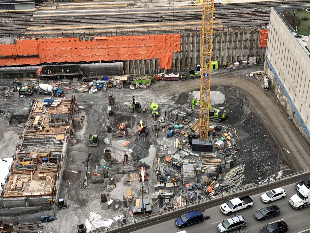

South West Corner: Earlier this morning a white cloth like material was spread over a gravel base. A new floor is being poured in the section under the platform along Bay Street. You may also notice that the P3 ramp has been graded from from east side up to west side. It's presently being used as storage for rebar and is covered in snow

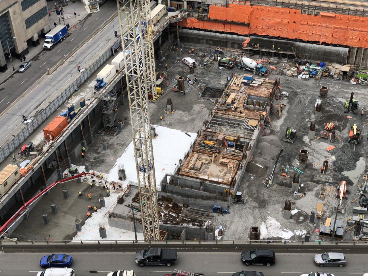

Westside Story: A floor is being poured over the white cloth like material. There is no rebar being used for this pour. The core continues to grow, floors have been poured and the tops are being covered in plywood. There are access doors to each of these rooms. At ground level on the west side of the core, towards the north section of the core, (a very dark looking rectangle) there is a new rebar foundation and some type of mounting bracket that is similar to the crane bases that were previously build, except the size is considerably smaller. Could this be a base for a more permanent concrete pumping machine?

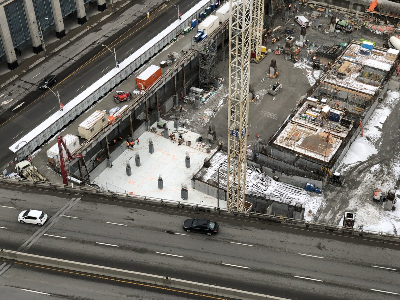

Eastside Story: Not much new here this week
Speaking to this, the white material is a vapour barrier which is installed below the slab-on-grade - helps to control the flow of moisture through the slab-on-grade. The pour you are talking about is for the lowest level slab and this does not require reinforcing as it is not a structural floor slab.
