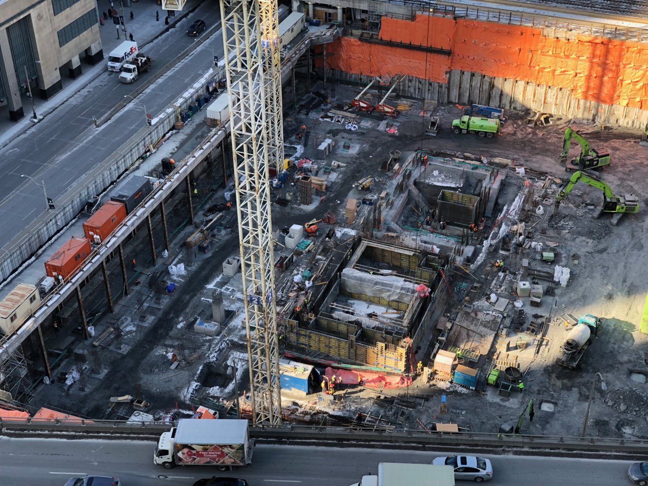

Westside story: Lots of forming going on. There are also some columns or piers rising from the ground. (Please correct me if piers is the incorrect terminology). There is a row of square foundations all in a row about 3m west of the main forming that I think will be called 'the core' of the building. Directly to the southwest of the core forming you can see the beginnings of a ramp rising. There is a blue container sitting in the middle of it, but if you follow the rectangular perimeter of rebar you can see the rise along north and south sides of the rectangle with the lower level being on the west end and the higher level on the east end. Under the platform there has been activity against the western wall along the east side of Bay St. They have built some rebar columns and covered the wall in large grid steel mesh.

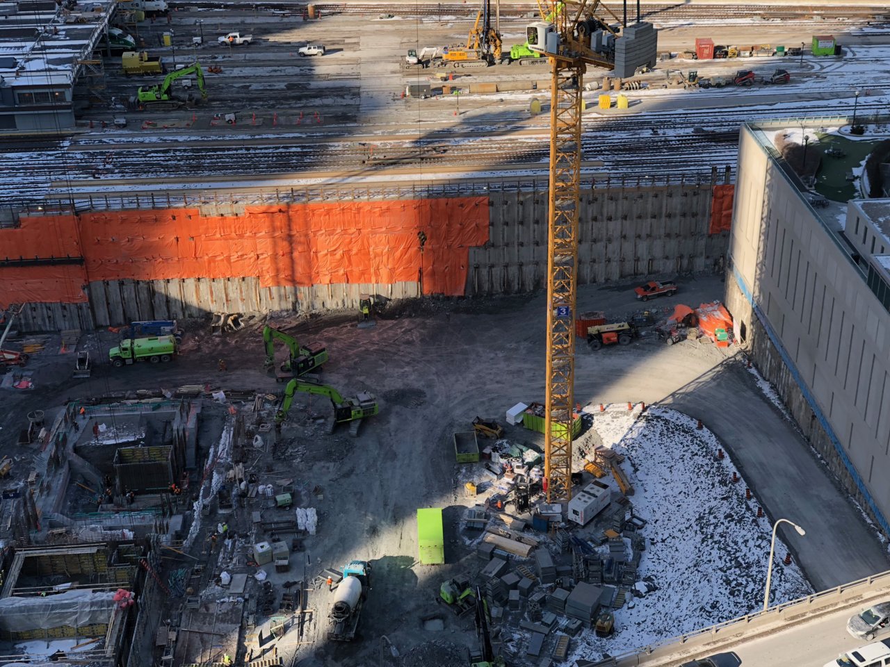

East side story: Not much new this week but I'll add a picture anyway or you can wave to the guy in the crane :)

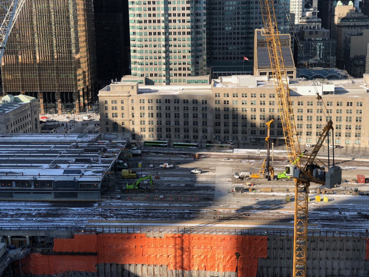

Trackside story: The boring machine has worked every night this week. Most action has been taking place on the platform just south of GO train #668? or #665? Sorry the picture is inadequate, but if you expand, even though it is very grainy, you will be able to see a set of orange traffic cones showing where the boring has been completed and one boring bit/tube that hasn't been removed from a hole in progress. It looks like the north boring will mirror what was done previously towards the south which continues to be marked by the orange traffic cones at the edge of the south end of the train shed.
