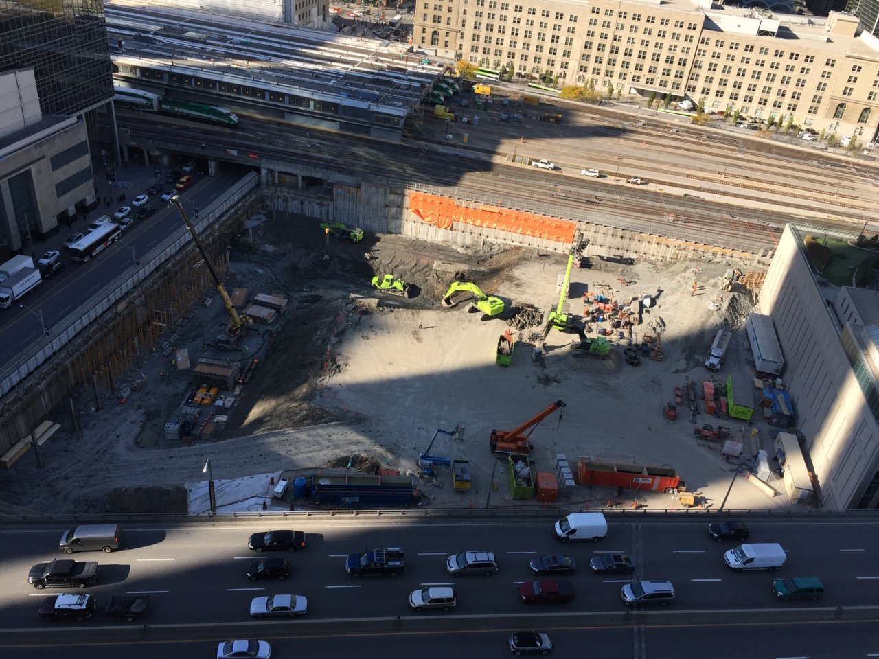

What are the additional vertical beams (inside the perineter wall) for? Are they remains of an earlier building or new for CIBC Square?
I would guess they will be support for the caisson wall. They can't use tiebacks in part to the subway
Thanks, makes sense as I assume the Bay streetcar tunnel is right under Bay (and thus immediately west of the excavation) and the new platform that will be in the CIBC Square basement will presumably be about here. Thanks!

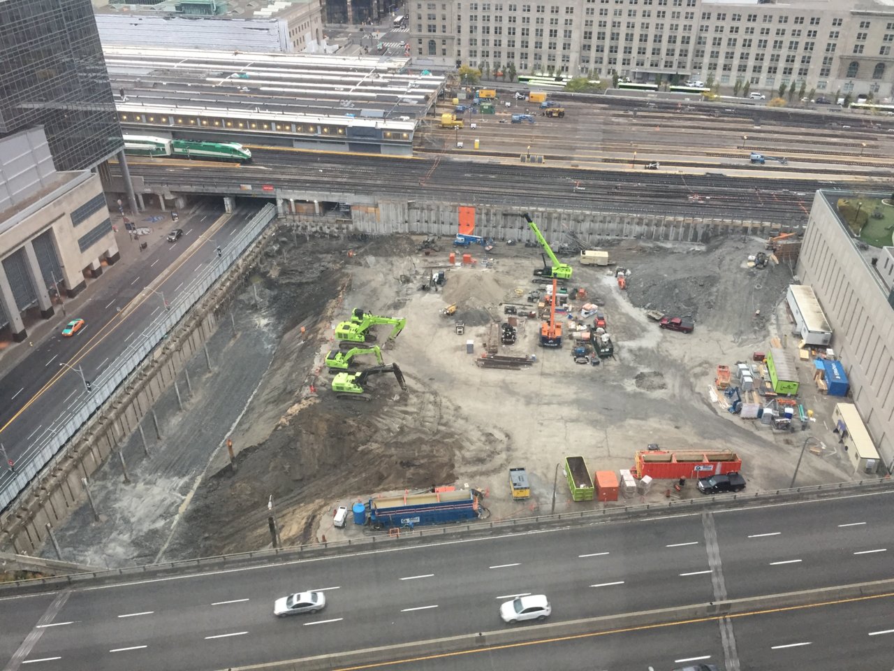

Friday Update. The hole continues to get larger but not deeper, along the Bay St side a new crew of scaffolders are erecting a structure (orange poles) from the lowest level up to street level. There are concrete forms piled up along with a lot of scaffolding grids. It runs between the soldier columns that were installed a few weeks ago and the Bay Street wall
While digging about 5m down and about 20 meters south of the north wall they found a square drain, it runs from under Bay St travelling east towards Yonge St. They've been slowly exposing it and breaking it up to truck it away. I don't like to make suppositions on what I think is going to happen so I just try to describe what I see while the work proceeds
They only have to go down 3 levels to P3.. could they just be doing it all in one go? Is it deep enough for 3 levels of underground yet?
Looks way too shallow for three stories to me but that could just be the angle from up above.
Looks like they are buidling a temporary platform for site offices and other materials while they continue to excavate
