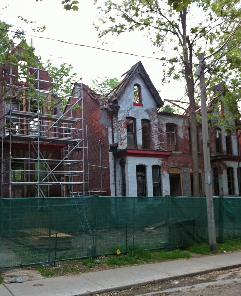

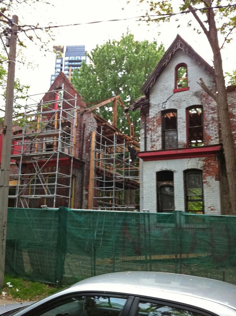

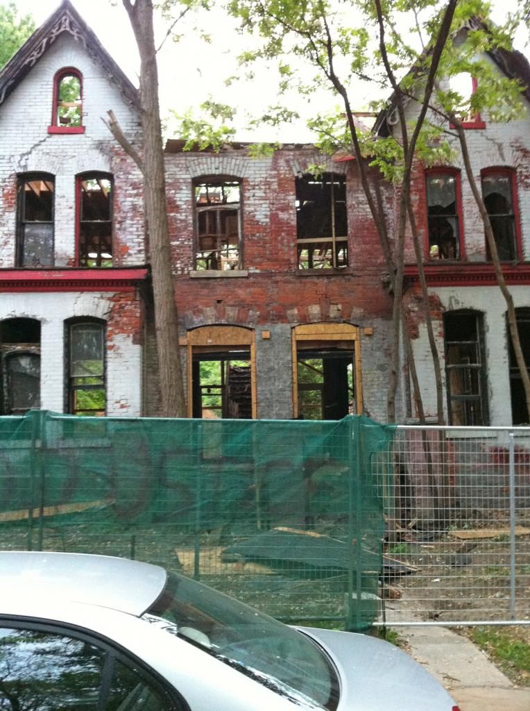

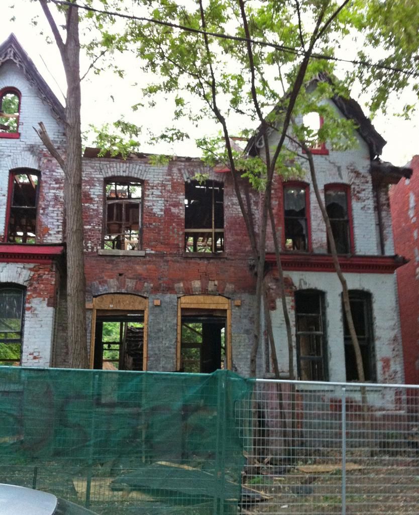

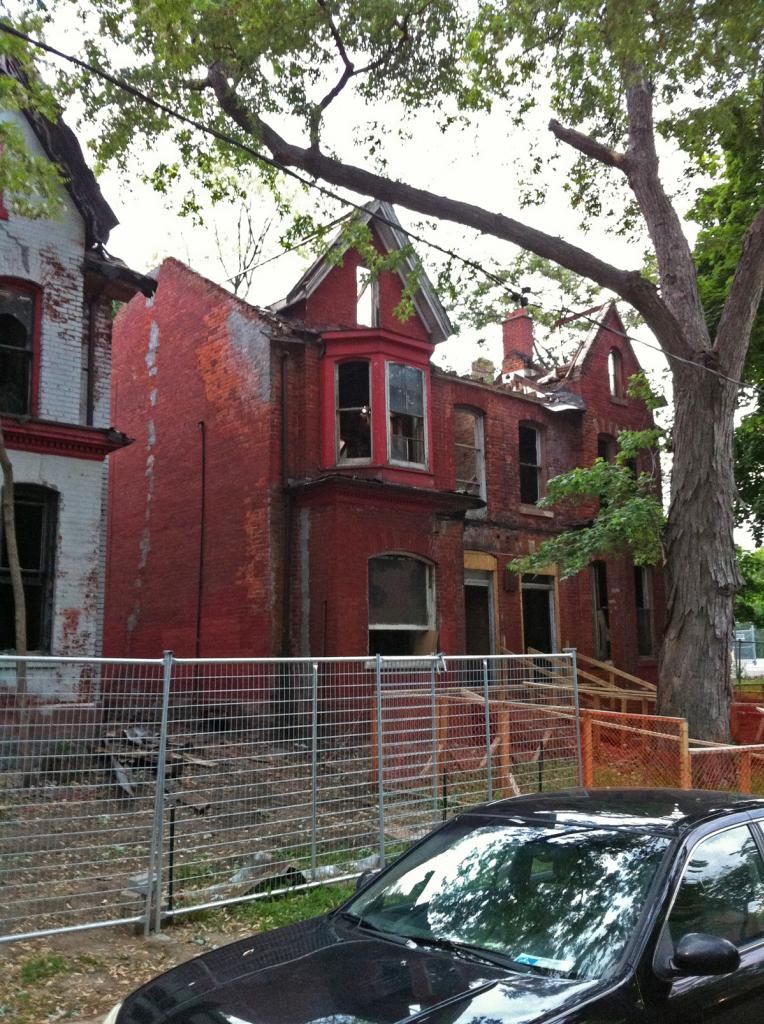

This doesn't look like much of a restoration. It appears that they are being torn down. (sorry for iPhone pics)
You don't put up a scaffold to tear down a house, you swing a ball into it (or similar). The gutting of the interiors here indicates however that structurally these buildings were compromised to a point that they have to do more to save them than simply sending in plasterers and painters. They wouldn't be spending this money if they did not need to.
alright, that's good. i hope you are right. a few of them are nothing more than facades at this point. that's what happens when you let them sit them and rot for a dozen years i guess...
on the other hand, the beautiful little apartments right across the road (some of the oldest walkups in the city), have been very well maintained, and are now undergoing restoration
Notice the lumber used to support the facade with the scaffolding. They're keeping the facade and rebuilding the house behind it. Hopefully, they'll do a full restoration of the facades and rebuild the houses to the same proportions as the originals.

You can see in some of those pictures how badly degraded the framing was. I'm amazed they didn't fall down. It's really a shame that the interiors have been lost, but at least the streetscape will be drastically improved once they get these cleaned up. I'm sure those properties would be worth a fortune if they were cleaned up
Although I love Victorian homes--both decayed and restored--it would be sort of interesting to see modern architecture behind the old facades. Glass boxes, red brick, or any such material a nimbytect could dream up.
Overall, doesn't look too bad. Cedar was used a lot back then. Massive joists that run the length of the house rather than the width. How we frame homes today is entirely different.
