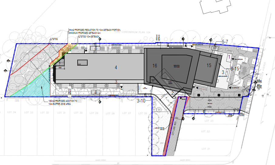

I see the new plan still doesn't respect the very basic rule of setting the building back 10M from stable top of bank.
This is not a big ask; it's an essential ask based on minimizing erosion risk and safety risk to people and property............
From the cover letter:
The proposed building footprint generally falls outside the 10 m setback line from the LTSTOS, though in the northern portion of this area a reduction of the setback to a minimum of 6 m is requested, whereas in the southern portion of this area an increase to the setback beyond 10 m is made possible.
Sigh!
No.
The proper ask, as it would be north of the City is 30M from stable top of bank.
10M is heavy compromise dealing w/the realities of existing and prospective development in the City.
It is not a negotiation position; it's a minimum.
The orange area below is the encroachment:

The Todmorden Wildflower Preserve who oversee the stewardship efforts in the valley below this proposal share my concerns.
They are likewise concerned about the negative precedent of allowing any encroachment into the 10M, stable-top-of-bank zone.
But they also reminded me, as with the previous proposal, that there is an impact on ground water here.
There is a seep roughly in line w/the lowest level of underground parking which would be impacted; that seep is almost certainly a source of water for the diverse, high quality wetlands at the base of the hill.
This proposal would divert that water into the City sewer system.
The solution here, is one less level of underground parking so as not to interrupt the natural flow of ground water here; along w/respecting the buffer zone at the top of the slope, as noted.

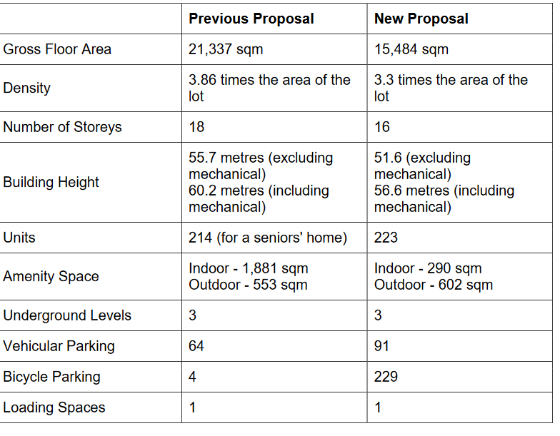

Then, from the report, a comparison w/the previous proposal:
The report doesn't work for me............

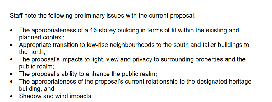

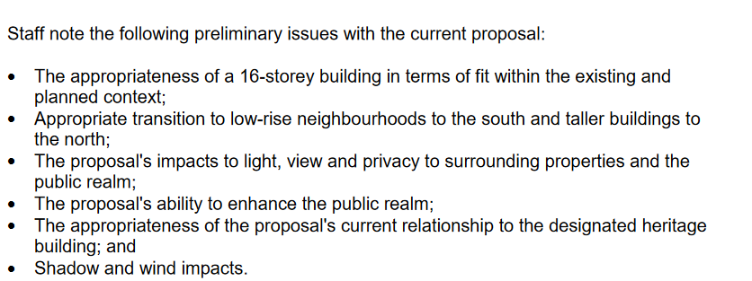

Here's the 'issues to be resolved' section:

And the most laughable part? While it's true that this is an extremely walkable, bike-able and easy-access-to-transit site, people will still have cars. The style and locale of the building will attract a downsizing demo from Riverdale, the Beach etc. The percentage of renters will be low. Boomers drive a lot: to get groceries, to their cottages, whatever. The city will not grant any overnight permits to anybody in the building. So good luck on those 90 parking spots for 220 units.
