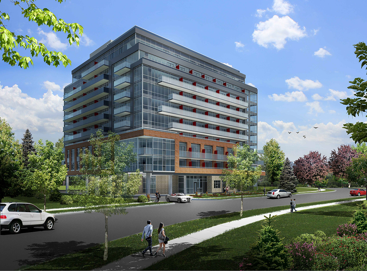

Interesting that Dash still have the previous Teeple concepted design shown in their website's project profile. So it looks like they held that for sometime after picking it up from Slobodsky, before going full garbaggio with this dreck.
Very clean and neutral. Should not offend anyone.
It's not clean, it's got four horizontal mullion lines per floor when there should be two. Neutral would mean no red balcony dividers, and actually I'll be surprised if that lasts and they don't go neutral greyish-green by the end. The precast frames tracing volume edges are what some people would tell you is architecture, and they might be if there were a hierarchy to them, or some attractive attribute they were highlighting, more than essentially just highlighting where the building bumps into angular planes. Then, possibly worst, half of what appears as windows now will have to be something else, more than likely back-painted grey spandrel owing to the City's thermal requirements (a good thing) and the inability of this design to hide walls otherwise (bad thing), so such things as the transparency at the corners is inherently deceptive.
This is inelegant, dishonest junk. Be offended.
Clean as in neutral colors. It's not a work of art and is not intended to be. It's not an important building and reflects that.
New renderings are updated in the database. There are some changes to the database information. The overall building height changed from 38.10m to 37.74m. Total parking space count changed from 127 parking to 128 parking.
Rendering taken from the architectural plan via Site Plan Approval:
