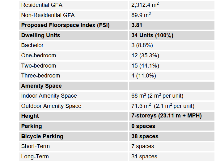

7 storey proposal for the above site (3459-3461 Dundas) is new to the AIC.

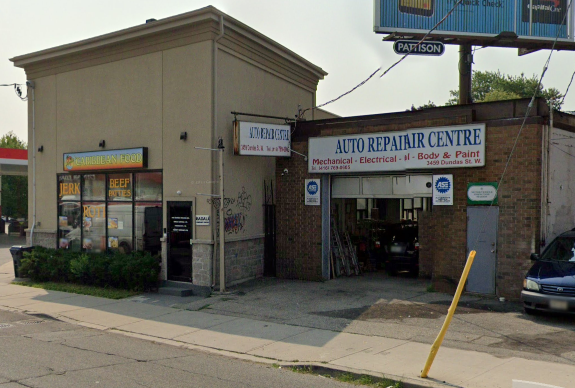

The site as-is, per Streetview:

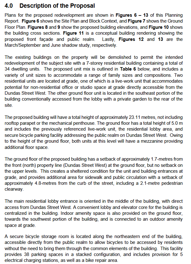

From the above:
Comments.

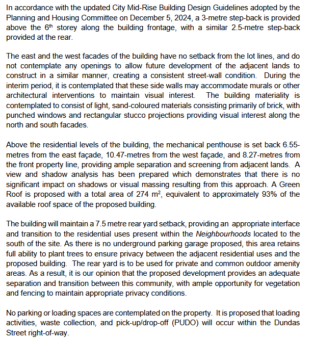

I agree this is a much needed addition to the neighbourhood, but 0 vehicle parking? The transportation report says there is ample on-street parking nearby for visitors and building residents, but I think most of the neighbours who already have permit parking would not agree. And I don't see the garbage handling facilities. Have to laugh at the observation in the transportation study about cycling infrastructure: "There are no designated cycling facilities on Dundas Street West, Priscilla Avenue, Willard Avenue, Durie Street, Jillson Avenue and Morland Avenue; however, cyclists were observed along Dundas Street West during the site visit on July 6, 2024. "

This project would be a boon for the area so I hate picking apart their application. But I dislike seeing poorly researched and edited documents in the application.

While I would 100% welcome this use and the scale along Dundas, the parking is concerning. The onstreet parking on Dundas is not 24/7 and the street is really busy and fast making onstreet more dangerous. There should be at least something for parking. Providing zero for 34 units not along a transit corridor is kinda dumb.

If the units sell without parking then there is demand. Let the market decide.
