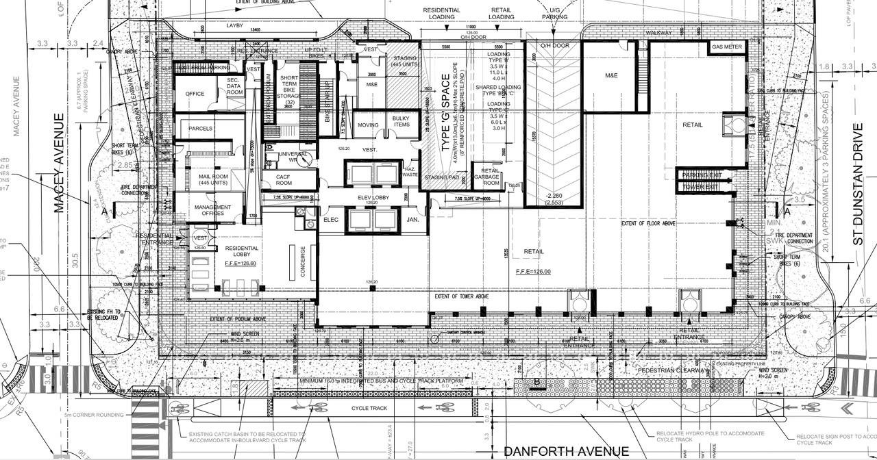

Ground Floor Plan:

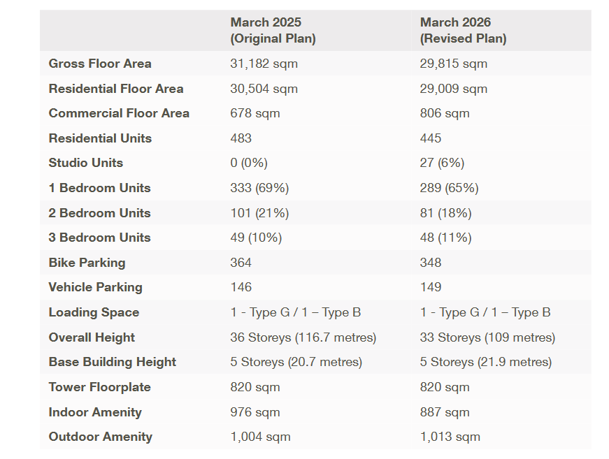

Development Summary/Site Stats:
Parking Ratio: 146 vehicle spaces to 483 units is 0.3
Elevator Ratio: 4 elevators to 483 units or 1 elevator per 121 units.

Moving along....... The ground floor plan is one area that requires major refinement. A bit over 1/2 of the Danforth frontage is devoted to retail. Far too low.
The residential amenity program should be removed from the ground floor or shifted to the side streets; The lobby is both too large, and should, ideally, be accessed from Macey.
Danforth should be lined with retail here, and the ft2 of same should be increased by at least 1/2, if not 2/3.

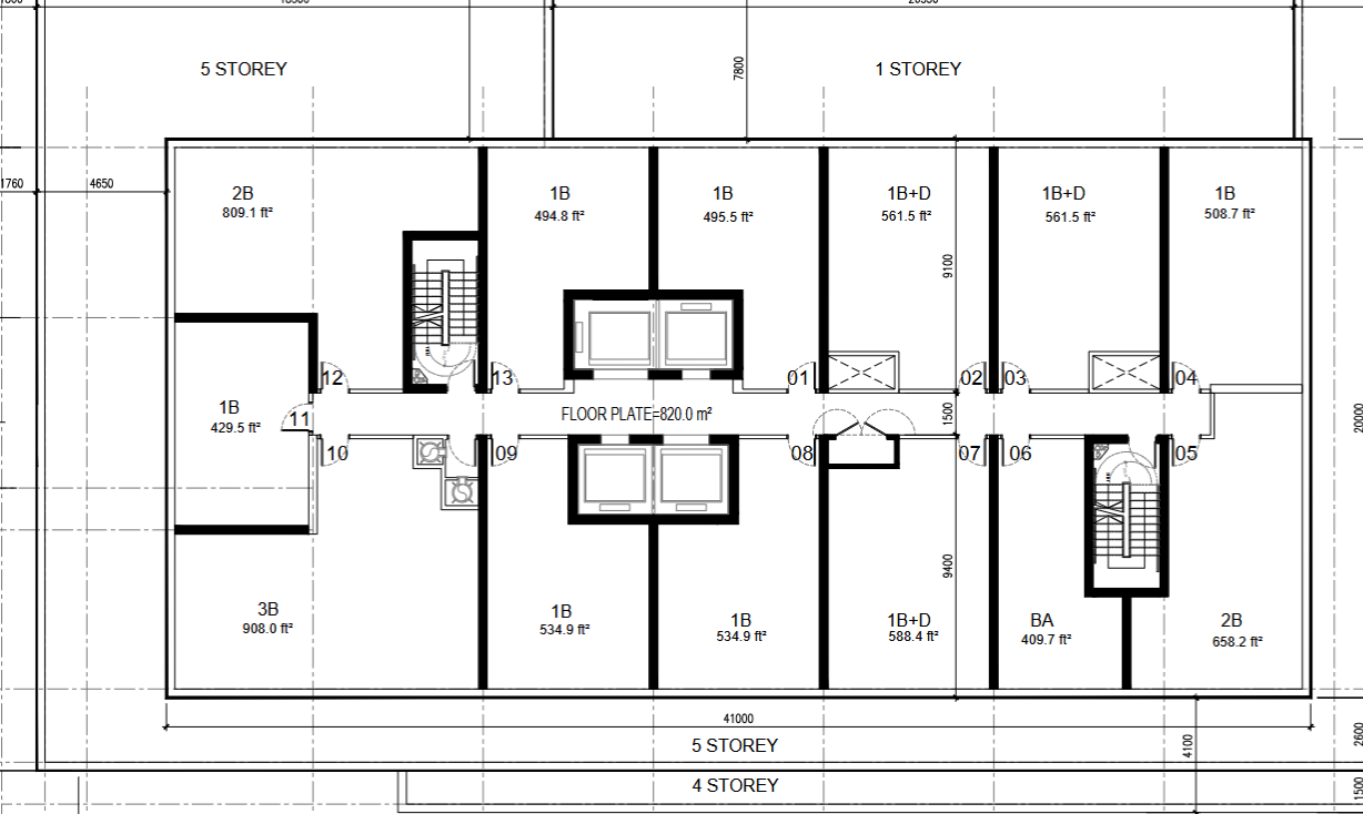

Next, the floor plate is over guideline at 820m2, I'm flexible..........but if you want extra, you need to give extra.

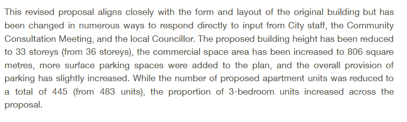

First, a resubmission at end of March '26, in which the height was reduced to 33s.
@Paclo
From the Cover Letter:
Unit sizes here remain too small:
Revised Ground Floor Plan:

Elevator Ratio in revised proposal 4 elevators to 445 units or 1 elevator per 111 units.
Comments: Unit sizes too small, tenure of condo is currently unrealistic, Ground Floor is improved considerably, but lobby continues to face Danforth, which is not ideal; glad to see we're sticking with off-site park acquisition.
