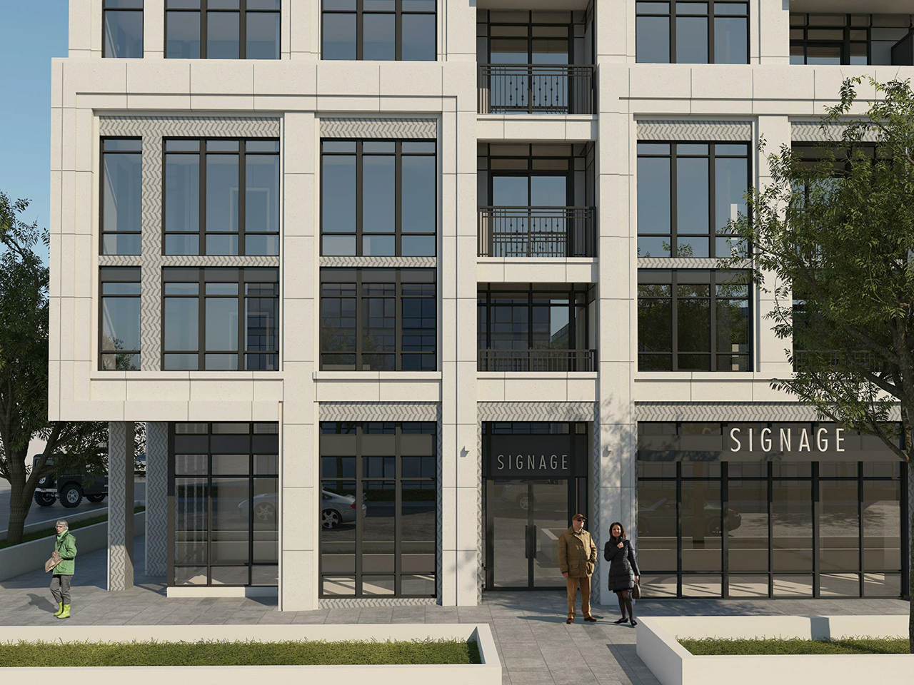

Not looking forward to this one, the detailing along the Sheppard frontage looks dreadful.

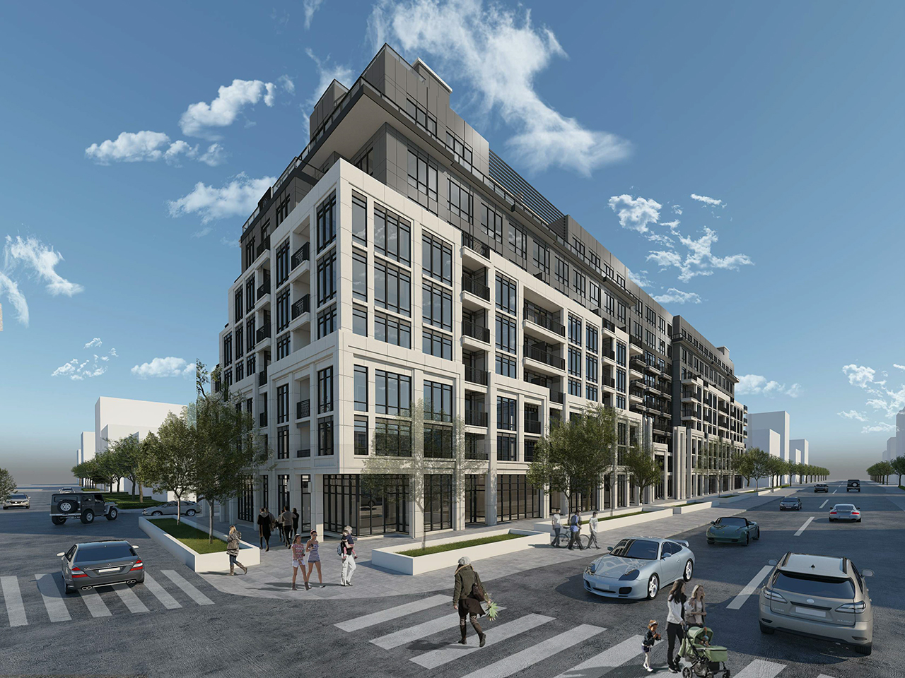

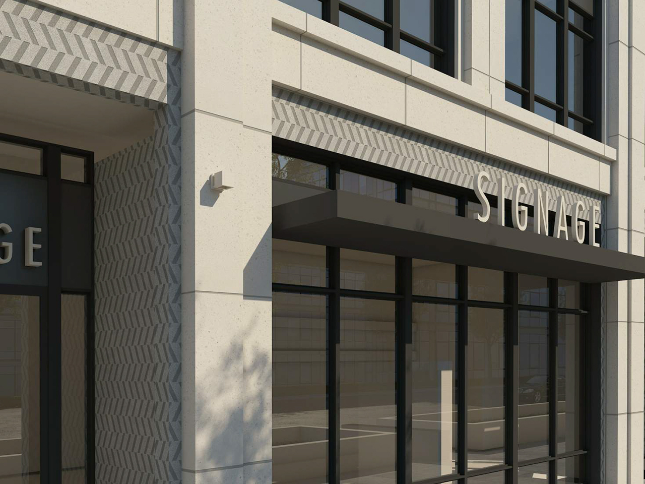

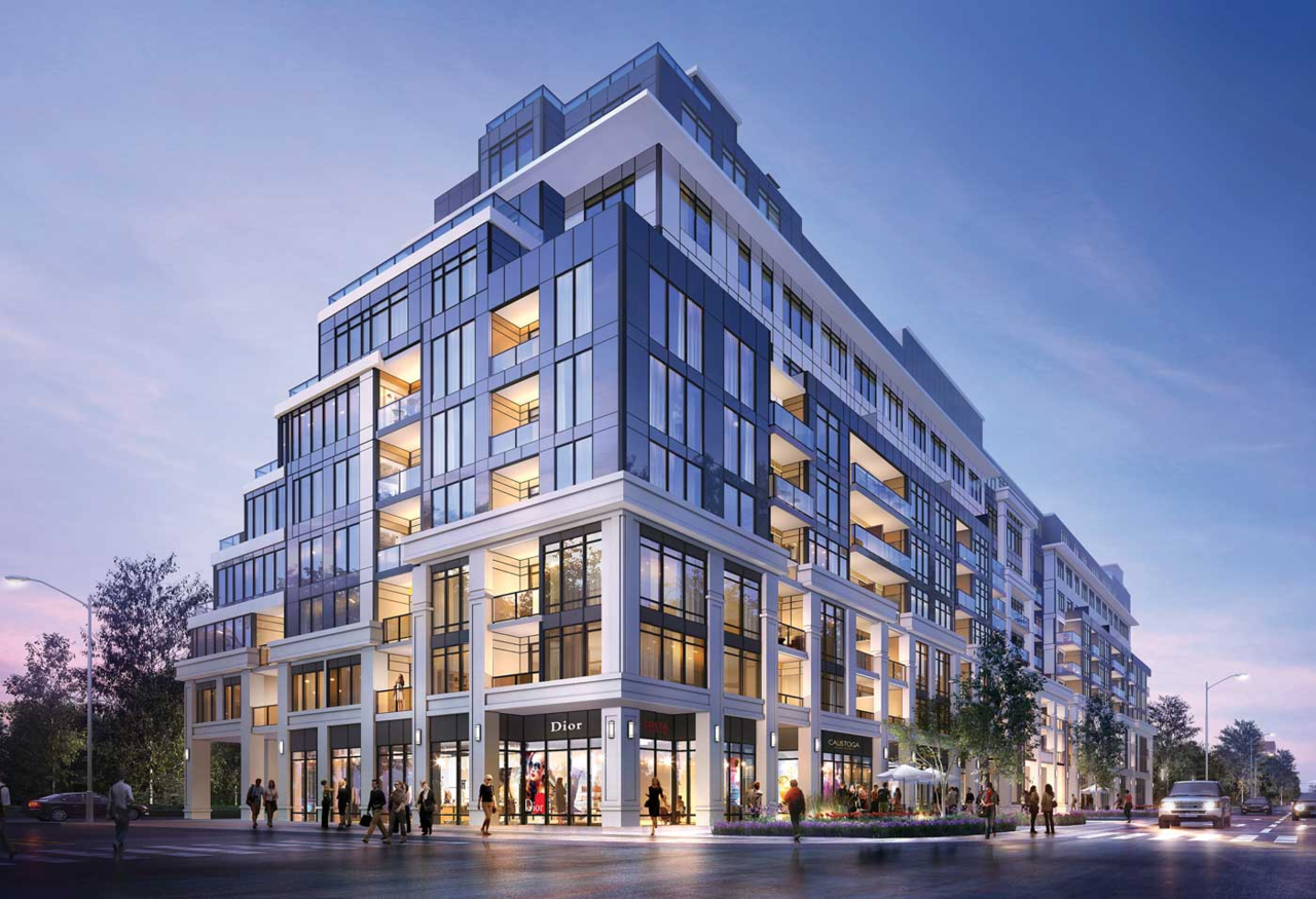

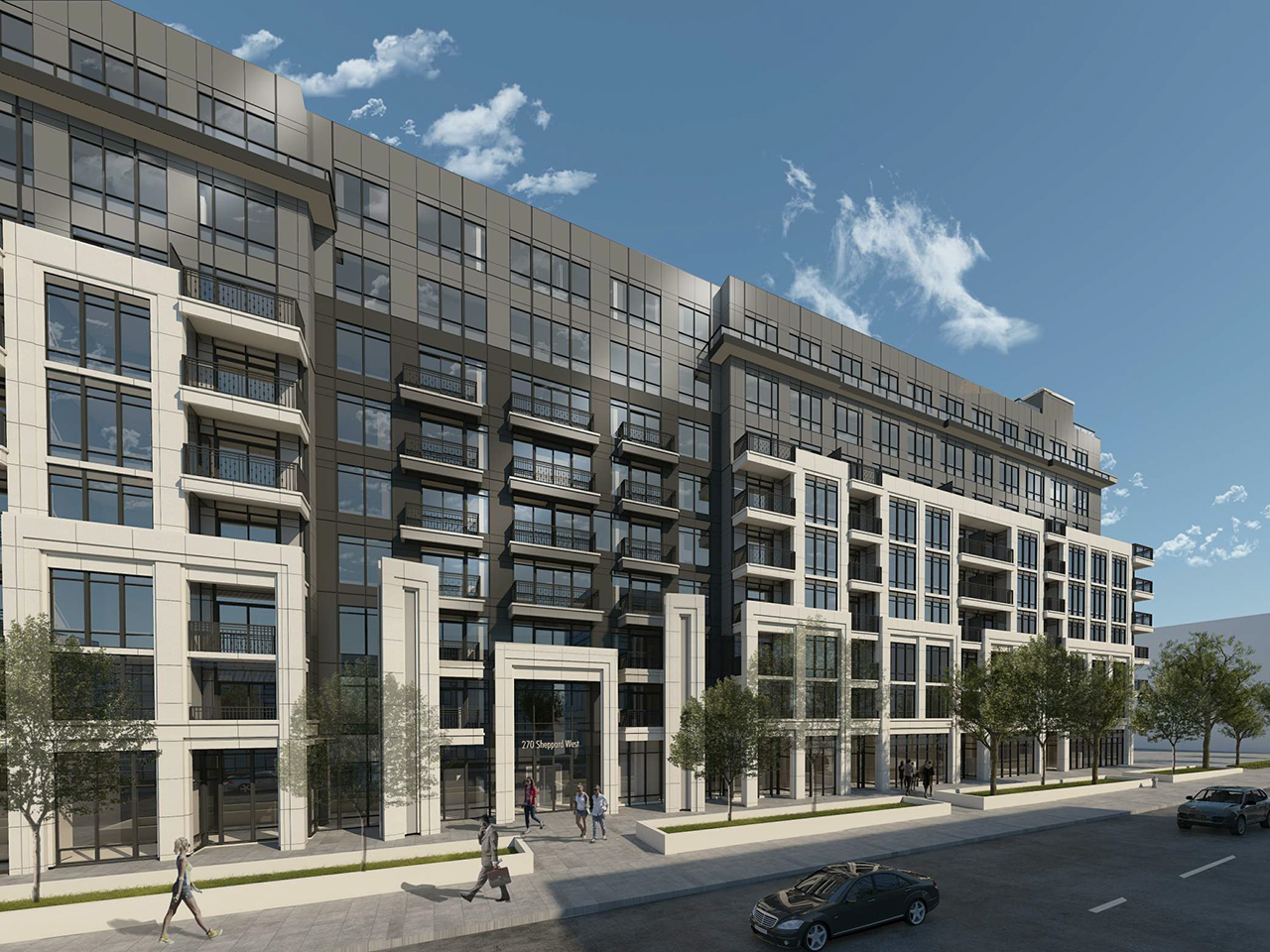

New renderings are updated in the database! Several project information has a few minor changes. The total storey count increased from 8 storeys to 9 storeys. The total building height increased from 28.35m to 31.75m. The total unit count increased from 163 units to 179 units. Finally, the total parking spaces remain the same at 196 parking.
The renderings are taken from the architectural plan via Site Plan Approval:

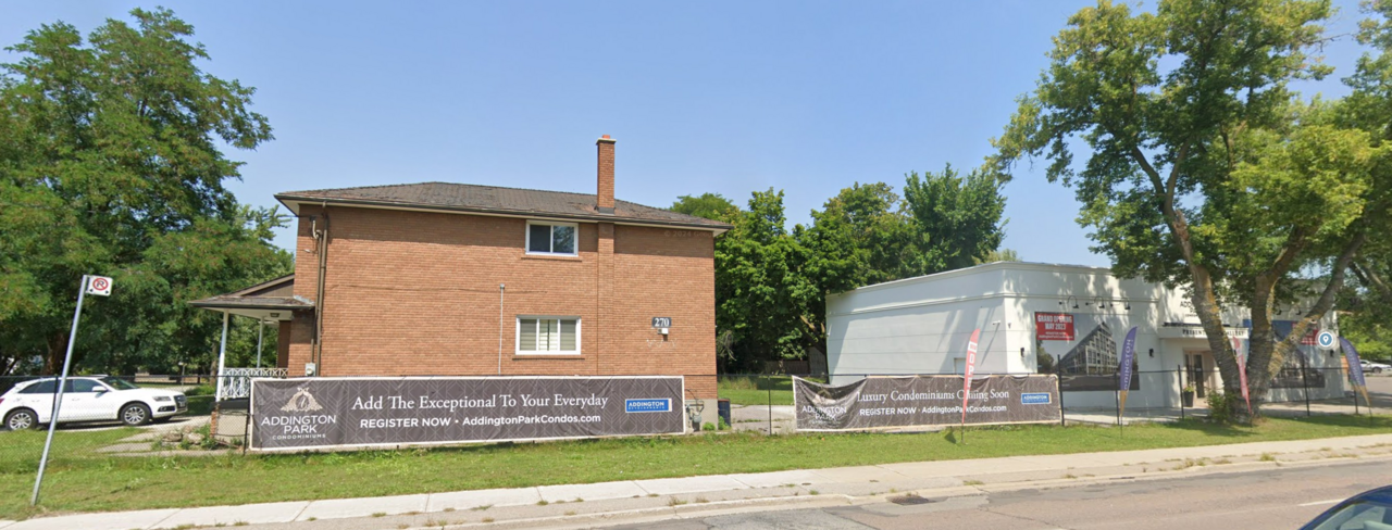

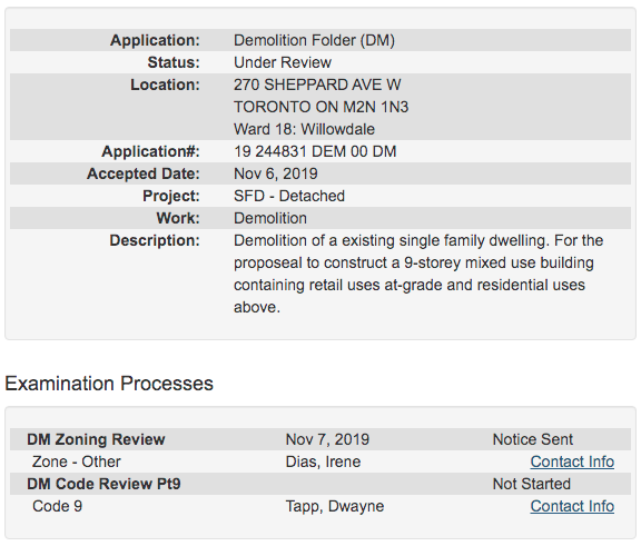

Demolition permits remain pending for 270 Sheppard W & 1-3 Addington.

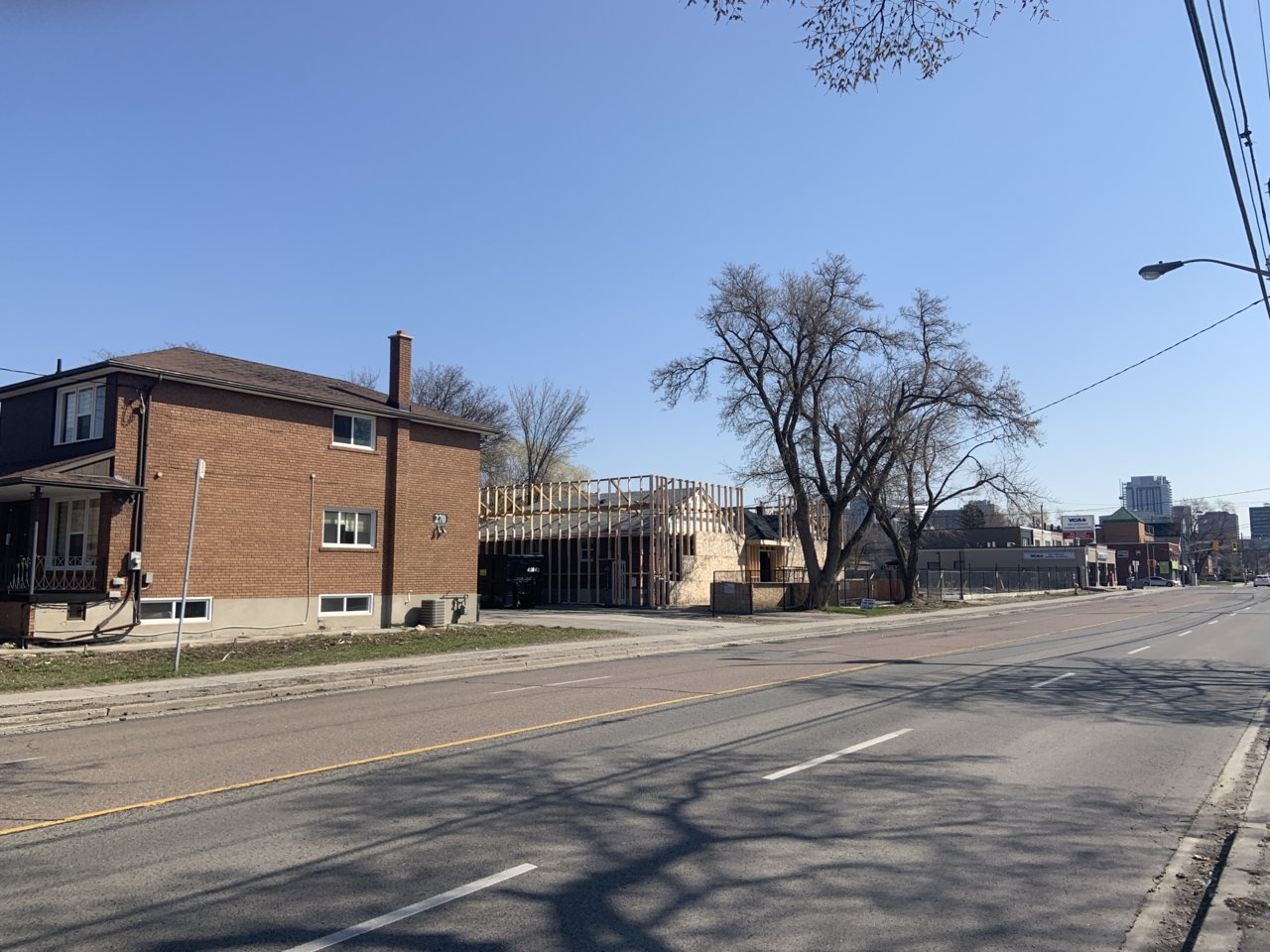

Site as of Aug '24 Google Street View:
This is fairly nice........
It appears to come from The Studio JCI of yesteryear, the one that knew what colour and warmth were. Is someone back from parental leave?
206 units to 3 elevators is 1 elevator per 69 units
Unit sizes are mostly decent, 3 beds could be a bit bigger (they're just in the 900s, and really need another 100ft2 or so). A few of the twos.........the layouts given limited windows will be 'interesting'.
I know there's a tendency to never give up a foot square, but pulling in a couple of light wells on the rear side of the building (north) would allow additional windows that I think would yield a higher rent per ft2, and you'd make a chunk of the loss on ft2 back.
This could be done more efficiently as well, by relocating the stairs towards the centre, then using the space behind the elevators/stairs as one of those light wells.
A single, light well, on the front, opposite the elevators, could be delivered with curved glass bringing light to the elevator lobbies, (an expensive, but small feature), with 2 units picking up new side windows on every floor.
