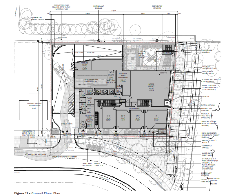

Site Plan:

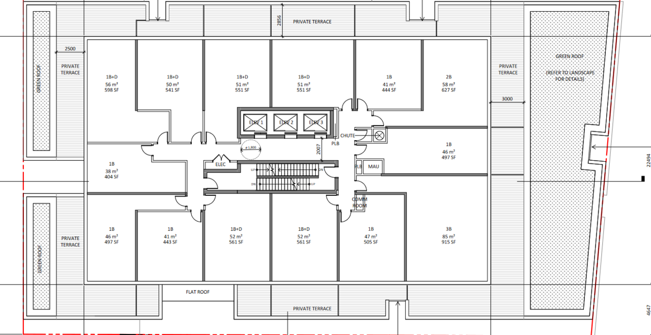

Ground Floor Plan:
Parking Ratio: (resident only) 0.2
Elevator Ratio: 0.98 elevators per 100 units
Not at all unusual, but I must note some atrocious unit layouts:
Look at those corner units and how much functional space they lose to huge entry corridors. Just split those micro 1bdrm units into the adjacent spaces and create livable space, with functional layouts! Less greed people!

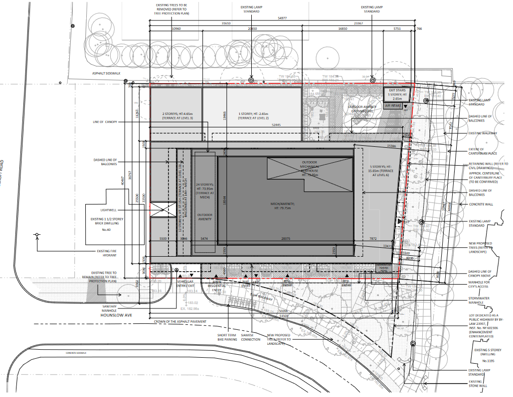

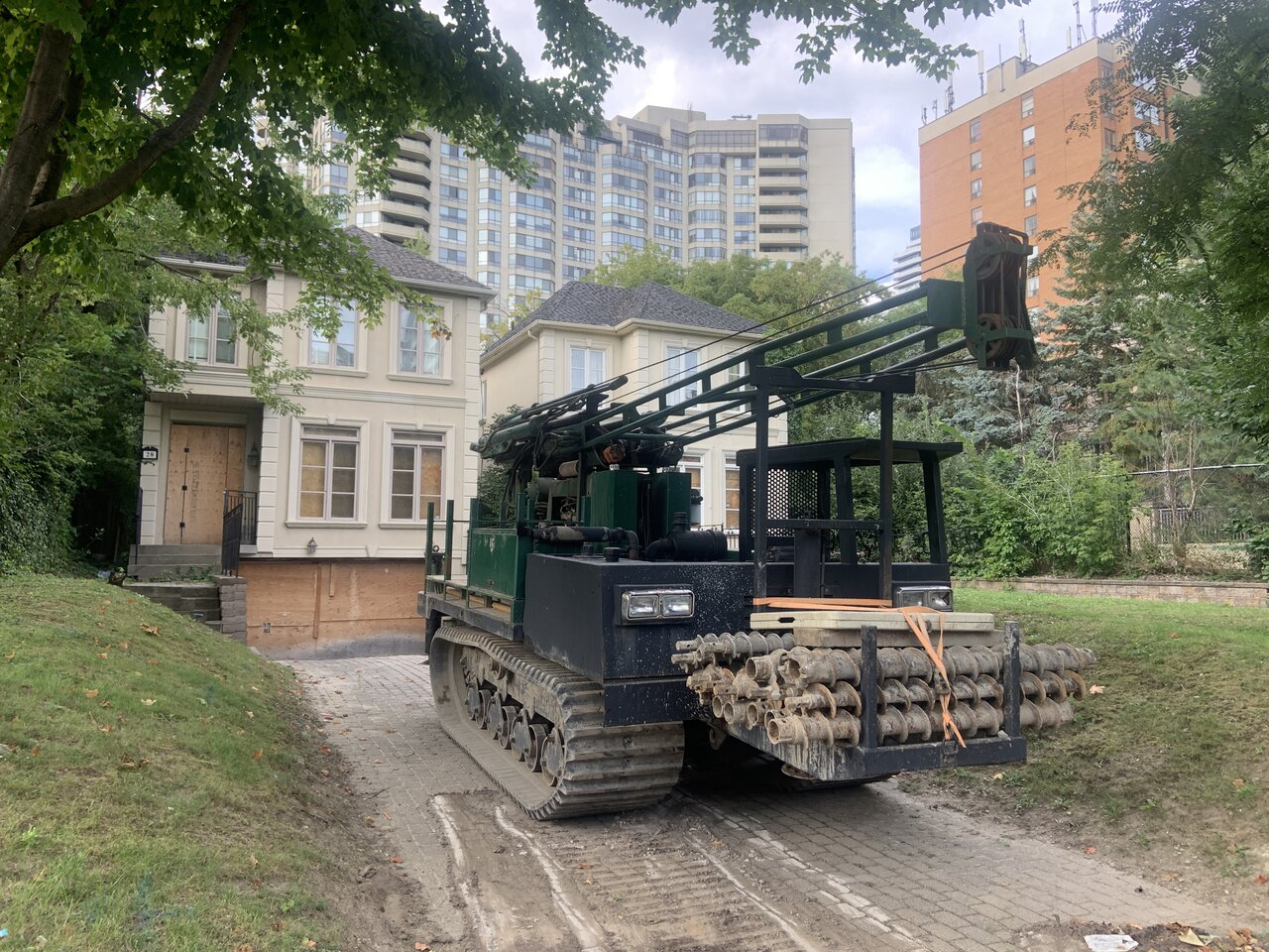

Additional Comments: PE must tell us if an offer was made/refused to the owner of the one remaining SFH on the block; it will be surrounded by towers, but with a stranded site that no one can build on.
The height ask isn't unreasonable, though it is taller than the immediately adjacent sites fronting Yonge Street which top out at 22s; Typical City instinct would be to want to taper the height down away from Yonge; while I imagine the applicant is eyeing the 32st approval on Yonge just to the south to make 24 seem reasonable.
I'm fine w/it.
Would prefer to see the remaining SFH bought out and the block logically completed.
Additional Comments: PE must tell us if an offer was made/refused to the owner of the one remaining SFH on the block; it will be surrounded by towers, but with stranded site that no one can build on.
While the hold-out Single Family House lot would itself be way too small to support a Condo tower - this lot will have Height and Density rights afforded to it under the North York Centre Secondary Plan - making it a valuable lot to be used by another Developer for Height and Density Transfer to another project. If this project gets approval for extra Height and Density at OMB/OLT - then the Developer buying this Single Family House lot would be justified to argue for similar Height and Density to be Transferred onto their project. After all that, this Single Family House lot would likely be conveyed to City as Section 42 Parkland Dedication to become another parkette,....

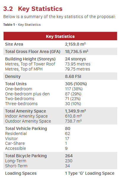

New stats added to the database. The storey count changed from 10 storeys to 24 storeys. Height changed from 38.60m to 79.75m. Total unit count increased from 111 units to 305 units. Finally, the total parking space count reduced from 113 parking to 80 parking.

A development proposal has been submitted for 26, 28, 36 and 38 Hounslow Avenue, seeking to permit the construction of a 24-storey residential building, containing 305 units and 18,737 square metres of total gross floor area, resulting in a density of 8.68 times the area of the site. The proposal includes 1,350 square metres of indoor and outdoor amenity space and 2 levels of underground parking which will contain 80 vehicular parking spaces and 264 bicycle parking spaces.
