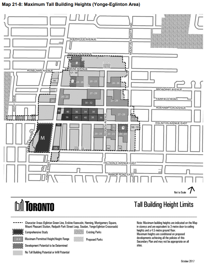

It's been a while since there has been an update on this project. I think there was supposed to be a meeting in the Fall. Has anyone heard anything?
Only thing of note I've seen was through the Midtown in Focus update. While height limitss have been definitively added for many parts of the area, Canada's Square's height limits are subject to 'further comprehensive study.' There's also proposed parkland where part of the parking garage with some nice older facade stands.

I really do wish midtown/ Y-E had more permeability and some of the bigger blocks or parcels were broken down to allow for more pedestrian through fares
You can already pretty much walk from Yonge to Redpath mid-block between buildings. I do wish the city took a role to make it more formal though, as to encourage it.
North of Eglinton, there definitely needs to be more pedestrian connections definitely, between it and Roehampton.
