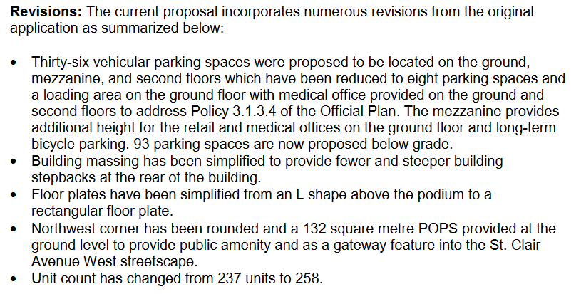

This one is the subject of a Decision Report - Approval Recommended to the next meeting of TEYCC:
Height unchanged; but there have been revisions:

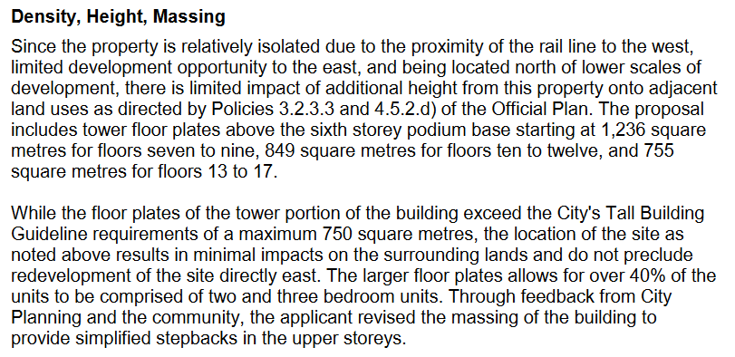

The above shows the effect of the angular plane rules being relaxed.........but there's something else here that UT's resident urban planners and architects will take interest in.........
as will @HousingNowTO
Have a look at the floor plate sizes

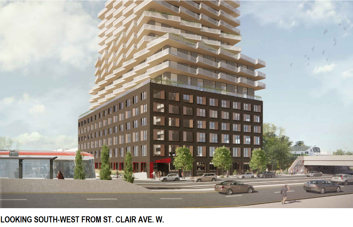

Revised Renders: (March '23)
I like the idea they're going with here including the zig-zaggedy balconies. Wouldn't mind seeing the use of red on the podium be more pronounced though.

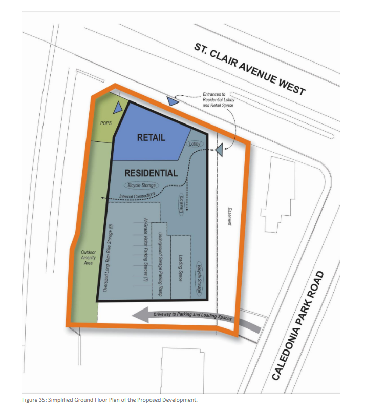

Ground Floor Plan (simplified)

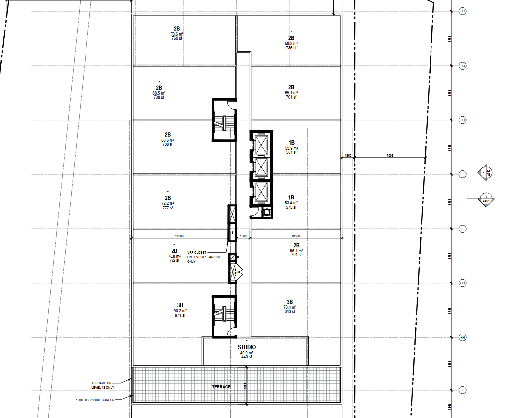

Typical Tower Floor Layout:
Elevator Ratio: 330 units - 3 elevators or 1 elevator per 110 units
Comment: Simplified massing makes sense here, additional height is fine, rental is good, elevator ratio passable. Most 1 and 2 beds are reasonable sizes, but the 3 brdms are light, the tower layout posted shows the need to chop 1 studio unit per floor and to allocate that to the 3bdrm units.
