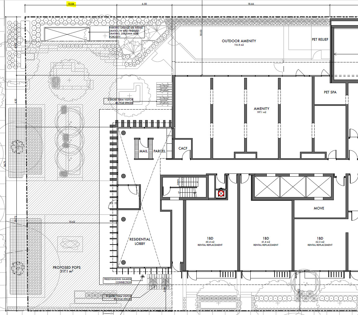

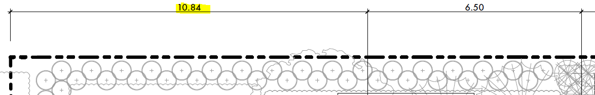

Don't think so... looks like an almost 11m setback on private property to the St. George property line
