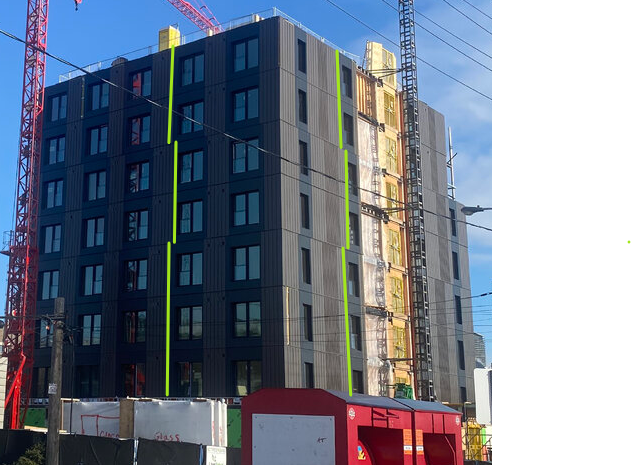

My biggest gripe with these newfangled designs is that they are trying to create a dazzle camo pattern on an otherwise regular rectilinear facade. And the results are usually less dazzling and more jarring. Just like with Halsa. There are no up-close pictures of it in finished state, so I will try to highlight what I mean on this picture by @YongeBloor :
Even though the windows are actually perfectly aligned in stacks, they are creating an illusion of shifted window sills every 2 floors with cladding colors. Its subtle on this picture but a lot more jarring in person.

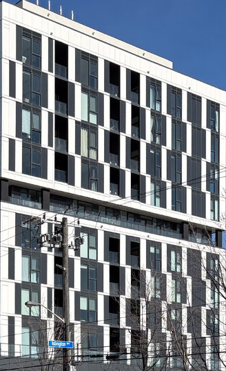

As far as jarring goes, at least it's not as bad as what they did over at Verge Condos:
original photo by @Lachlan Holmes
