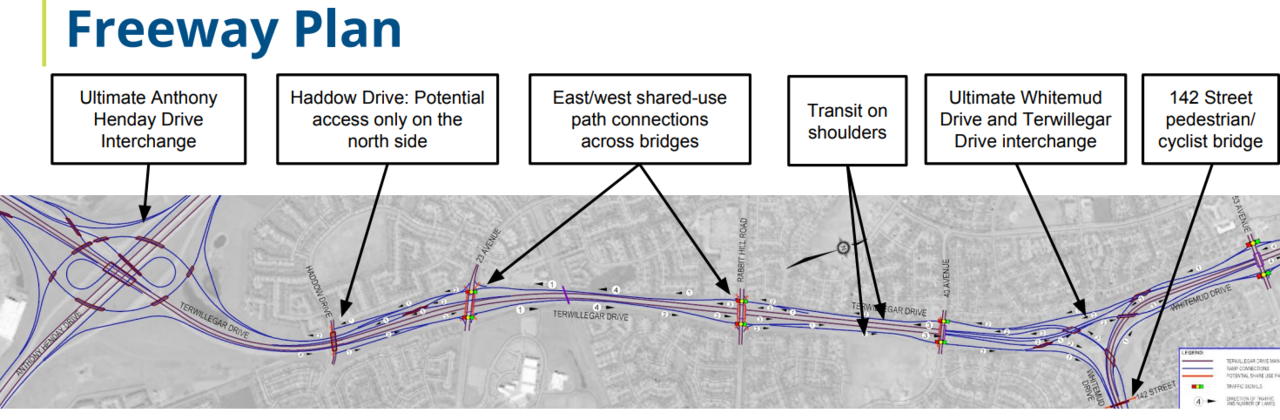

I really hope they reconsider the Terwillegar/AHD drive interchange for Phase 3. Just have something similar to the SPR/100 Ave/AHD interchange, the earthworks are already roughed-in for it and it saves everyone a lot of pain down the road.
Have a dedicated pedestrian crossing at 156 St instead, like with 142 St over WMD. Can't believe the Province isn't up in arms over the proposed design, they almost killed VLW over the AHD crossing as well.
I believe was initially proposed when they were still discussing freeway or expressway option
Yah that cloverstack is closer to what the west YHT/AHD interchange looks like.
You can see how the SPR/100 Ave/AHD interchange has this weird configuration where the EB/WB lanes are pulled apart and the ramps come in on the wrong side (fast lane). It looks like Terwillegar/AHD interchange is similarly set up and it actually works better because then incoming traffic doesn't have to cross over the bus lane.
The Province is footing the entire cost of this interchange upgrade so it's really strange that they don't push back heavily against what was proposed.
