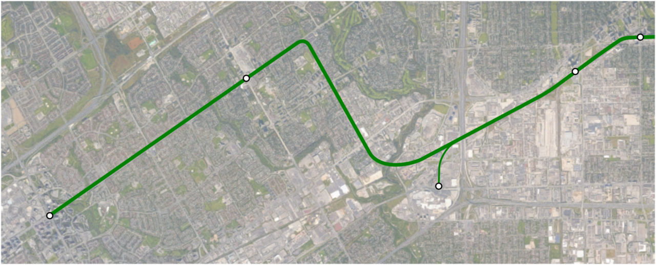

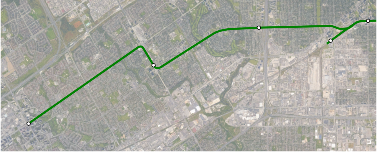

Hypothetically if reaching Sauga with Line 2 is the goal, wonder if it'd be better to just not extend from Kipling. Seems like after Islington we could branch the current surface portion behind 22 Div, then transition to an underground alignment back to Bloor. This would have to be included in the Westwood + new Etob Civic Ctr plans. Could then continue on Bloor offering stations at West Mall, Dixie, then Hurontario/Burnampthorpe.
If reaching Sherway is the goal, I dunno maybe continue west from Kipling using CP's ROW (well, tunneled below it). A spur could be sent south to Sherway with the rest veering across Etob Ck, then northward tunneled below the hydro ROW to Burnamthorpe.
Via Bloor
Via CP + hydro ROW w/ Sherway spur
