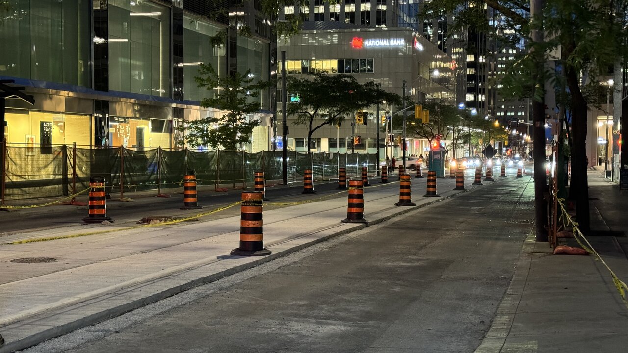

Oh, this photo reminded me of something I wanted to talk about.
You can see on the north-west quadrant of the intersection they have added this tiny little raised island, the one surrounded by cones on the left of the image. It is literally blocking the bike lane for straight through travelers, so cyclists have to go around it, hence the cones as a warning, I guess
I do not understand its purpose.
It's a component of a protected intersection and is supposed to increase visibility of the conflicting movements of a straight through cyclist and a left turning vehicle. For traffic approaching from the west, cyclists are meant to proceed on the left and motor vehicles turning left should be passing on the right. There's a video a few pages back here (courtesy of @UntitledCyclist in his post here) showing that its function is not obvious to cyclists, and perhaps needs some improvements.
