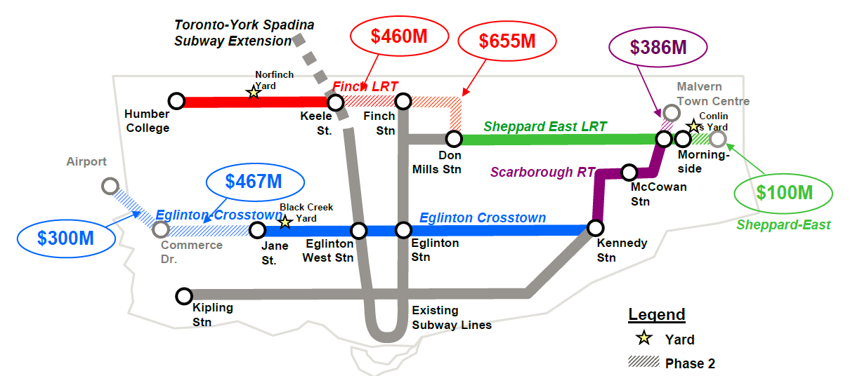

I don't think the scope was cut back. It was deferred. The report announcing that it would stop at Mount Dennis or Jane, referred to the next pieces as Phase 2. Ditto for the piece of Finch from Keele to Don Mills Road, Sheppard East past Morningside, and the SRT north of Sheppard.
^I wonder where that map was when Tory accepted the recommendation to build LRT and not heavy rail.
Had he said “we want Dalton’s Phase II put back on the table” instead of “we want Smarttrack to the airport”, he could have passed the bill to Wynne.
Either he gave away the ship, or it was well understood that Dalton’s Phase II was never going to happen, ie the deferral was a cancellation in disguise.
