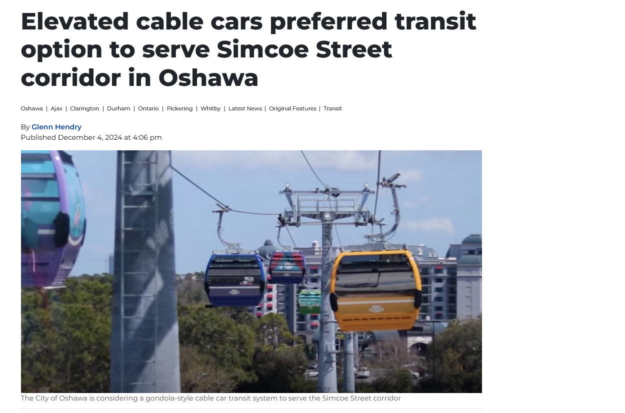

The website for the project; if one can call it that at this stage:
According to the FAQ, the earliest construction on 'something' might start is 2030.
Which, to my mind, makes the whole exercise more of a consultant enrichment scheme than anything else..........

For the preview deprived and the click-averse we need to bring forward the headline and associated picture:
There is a case for technology of this type in certain applications.............but I don't think Simcoe St. in Oshawa is that case.
I don’t really think gondolas fit for singular urban corridors at all, honestly.
They do best where there is a grade that cannot be climbed reasonably by any other mode. Flying over hilly neighbourhoods in South American cities, or wherever else. They are essentially in lieu of a funicular- “connectors” really.
The Hamilton escarpment could make better use of this tech, or to connect a hypothetical GO station in the Don valley to Broadview or Castle Frank station. But as either case would demonstrate, the tech couldn’t really be true rapid transit for the actual, identified corridors.
