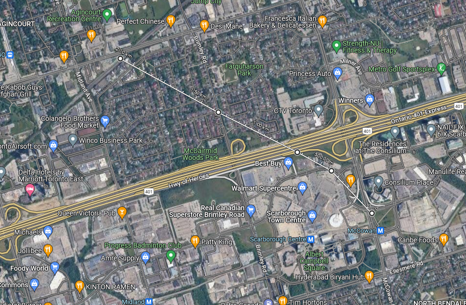

Let's have a look at this route:
So in the south-east, I've started the line exactly where the SSE subway station is being built. The existing line is deeply tunneled here, and the proposed development at STC precludes any realistic surface or elevated option on the south side of the 401.
The subway will not withstand a sharp change in grade, and therefore cannot be expected to be elevated over the 401.
The alignment north of the highway as I have shown it, could cross subdivisions, while the property, by Toronto standards would be relatively cheap to acquire, moving to an open trench means cutting off most of these communities from surrounding major roads, unless you build bridges over the open cut. It then would have to dive more deeply again.
Since its more than likely Sheppard will be tunneled up to the point of any southern turn and it would have to pass under the CP mainline, I see very little room to get the line up to the surface or close to same then dive down again under the 401.
The 401 which carries considerable weight, also has bridge pilings, electrical conduit and significant drainage infrastructure underneath it, indicating depth under the highway would be material, not shallow.
That is not an argument against such an alignment. Again, evidence is needed of what the built-out transit network will look like here.
Rather its a suggestion that people are putting forward options that I would charitably call fanciful without a clear understanding of feasibility or cost.
* note that any southern link to STC must cross both the CP Mainline and the 401, and cannot reasonably head south before crossing the Stouffville line as well.
Also, again, train storage, unless we know this line will have access to Wilson, it will have to have an east end yard somewhere, which is far and away most likely to be in/adjacent to CP's Toronto Yard, which is well north of Sheppard rather than south.
What is your source for this? I am not aware of any conventional knowledge which suggests subway tunnels are in any way cheap.

Let's review your imaginary alignment. There is clearly no space to elevate immediately south of Agincourt GO Station, as you need to traverse the CP Mainline, and you do not have time to make the requisite climb. Even a steep gradient would not get you to the surface in time, never mind clearance.
Note that I made the favourable assumption that the train was fully turned south, with its north end abutting Sheppard.
Once you're underground under the CP Mainline, you also have to stay under Highland Creek. Note then that if you brought the track up above grade between the creek and the 401, it would only be feasible if you were relatively shallow to begin with. But, there's a small problem............. You're going to emerge in the midst of the high-risk floodzone for the creek, which would make the tunnels vulnerable to water infiltration.
Blue is the flood risk from the TRCA flood risk map.
Assuming you avoid this by staying underground until you clear the 401......well, you'll note that the blue continues to the south.
I suppose you could surface in the middle of Progress Avenue and go elevated from there, but that will require considerable expropriation to widen Progress for a portal.
You would then have to rigidly follow the road alignment all the way to the proposed SSE station, and I'm not all clear how that's going to work, including turning radii with the new at-grade crossing of McCowan and the new road grid in the area.

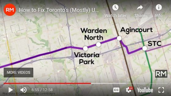

As a side note, having now listened to your video..............The Sheppard line will be six-car trains not 4. That decision has already been taken internally for planning purposes.
Once again, please note, I am not arguing against your proposition of going to STC, merely suggesting additional information, which I outlined in previous posts is required to determine if that is the best course (it may be, that is TBD).
What I am arguing is that the case has been made on scant evidence, and that in the course of defending your choice you've made statements which also lack proper support.
Once you're underground under the CP Mainline, you also have to stay under Highland Creek. Note then that if you brought the track up above grade between the creek and the 401, it would only feasible if you relatively shallow to begin with. But, there's a small problem............. You're going to emerge in the midst of the high-risk floodzone for the creek, which would make the tunnels vulnerable to water infiltration.
