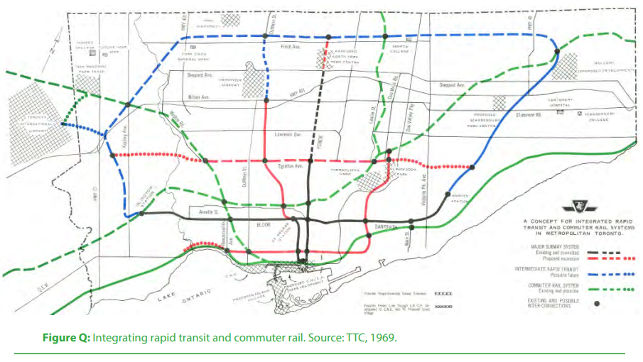

A light metro across Scarbo was the OG. It goes back to the 60s! Then carries on for two more decades. There are dozens of maps that show this.
You' would have to dig up that plan for me. I don't think it's a wide 25km network of grade separated metro covering various parts of Scarborough, at least that's the impression I got from afrasen's post. 🤔
You're looking for a combination of the early Scarborough RT stuff, which is really more light rail oriented (more Calgary than Transit City though) and GO-ALRT.
This is from 1969. There may be some from earlier, but basically the concept continues through the 70s and into the 80s. Eglinton appears sometimes. That would give about 25km.
This is from 1969. There may be some from earlier, but basically the concept continues through the 70s and into the 80s. Eglinton appears sometimes. That would give about 25km.View attachment 397549

Possibly. But I think it was neither. If I was following the discussion I believe the 25km was more a reference to a future, unexplored subway alternative in lieu of a Sheppard extension. As in: 10ish km of heavy subway extension or 20ish km of lighter subway. The follow-up reply to this was that Sheppard reigned supreme throughout transit history as a always a heavy 6-car subway. Reality however is that a large network of intermediary subway-like system had in fact been considered prior. Not unlike the Eglinton or Queen corridors.

Also bear in mind that if we’re talking about the OP level, those dashed lines are, with some realignment and updating for projects since the 60s, still there.
Line 4 sort of replaced (or was to replace) the eastern portion of that light metro line.
Emphasis is on sort of.
