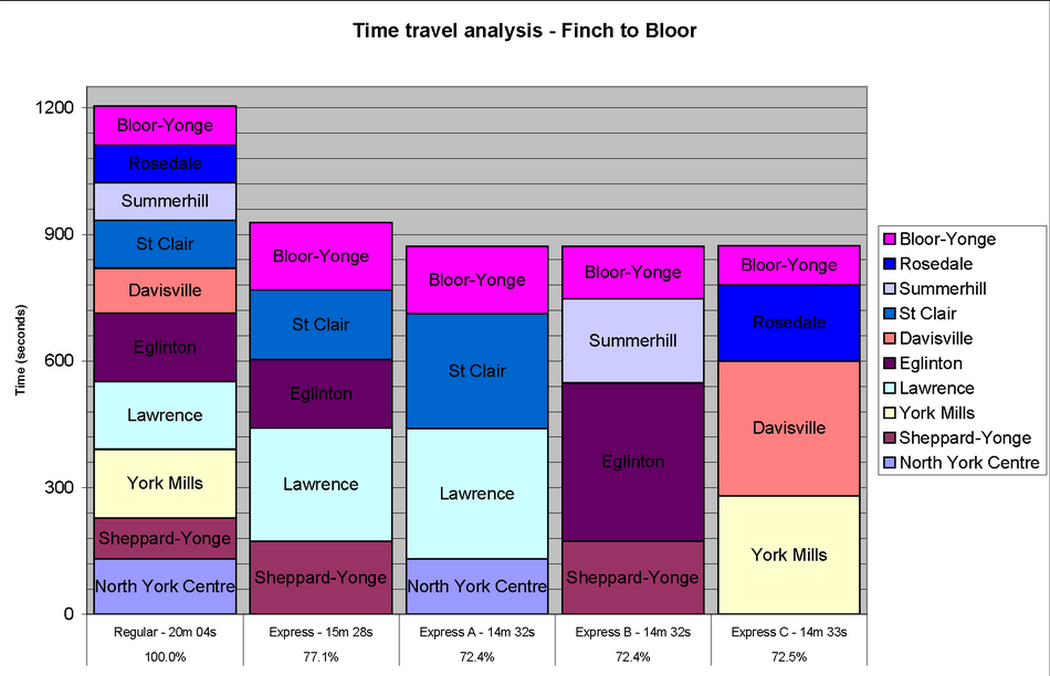

Made some numbers crunching... ExpressABC method gives next to nothing in improvement of Express method. But complexity of that ABC method is unbelievable. 23% of improvement for Express method is pretty good but it's only for the Finch-Bloor stretch.
That still doesn't address how travel in both directions will be obtained without adding a third track, or multiple crossovers.
Hmm... 7 minutes of staring at the white tile at Eglinton. That sure makes for a fun trip.
Victor,
This was wonderful work. You got it.

bY THE WAY, WHERE DID YOU COME UP WITH 20 MINUTES, FROM fINCH TO yONGE AND bLOOR?

Further, have you done the math for the extra commuting time for people to backtrack to get to a station where the train will serve their destination? You aren't saving any time if you have to wait for a northbound train, travel north for one or two stops then wait for a southbound train that will then save a couple of minutes.
Or for those heading to Bloor (or any station south, presumably all served by your stations skipping trains), have you done the math for the extra wait for a train that will actual stop at their initial station? Only one third of the time will the next train actually stop for you, so the majority of the time, you have to wait an additional one or two cycles while struggling with all your might to avoid falling into the pit of death.
