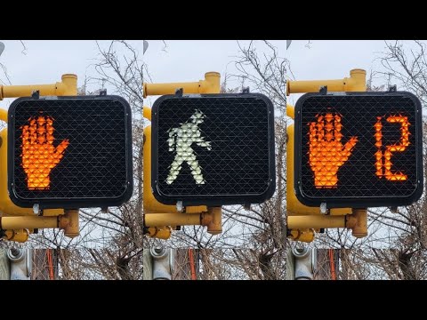

Is there any particular reason we can't have these compact pedestrian signals in Ontario?
Source
(Victoria, BC)
It just seems silly that these don't seem to exist in Ontario, while they're seemingly common throughout Canada.

Because we prefer upbeat / happy walking guy vs down / depressed walking guy.
The Highway Traffic Act Regulation 626 says that the hand outline rather than the solid hand indication must be used for pedestrian signals, but I don't see anything in it that precludes side-by side signal indications. (https://www.ontario.ca/laws/regulation/900626)
The OTM Book 12 also allows having those compact side-by-side pedestrian signals as an option (Chapter 2.7). But per TAC guidelines, they recommend having the countdown below the walk/hand icon. (Chapter 5.7). Why the TAC recommends that, I don't know, but it does say that having the countdown and the hand indications side by side is allowed in retrofit situations.
If I blur my eyes a bit, the solid hand look more like an amber circle. Which if it stays amber, means to stop, look around, and then go. Seems like an accident waiting to happen.
First time I saw the newish ones in Montreal, in the moment it took me to process it, I did the wrong thing. The countdown went to 0, and instead of just being a hand, it stayed at 0 ... so I started to cross. In retrospect, that doesn't make sense ... but that's what happened the first time I saw one.
I think the 0 should just vanish, instead of staying there the whole time.
