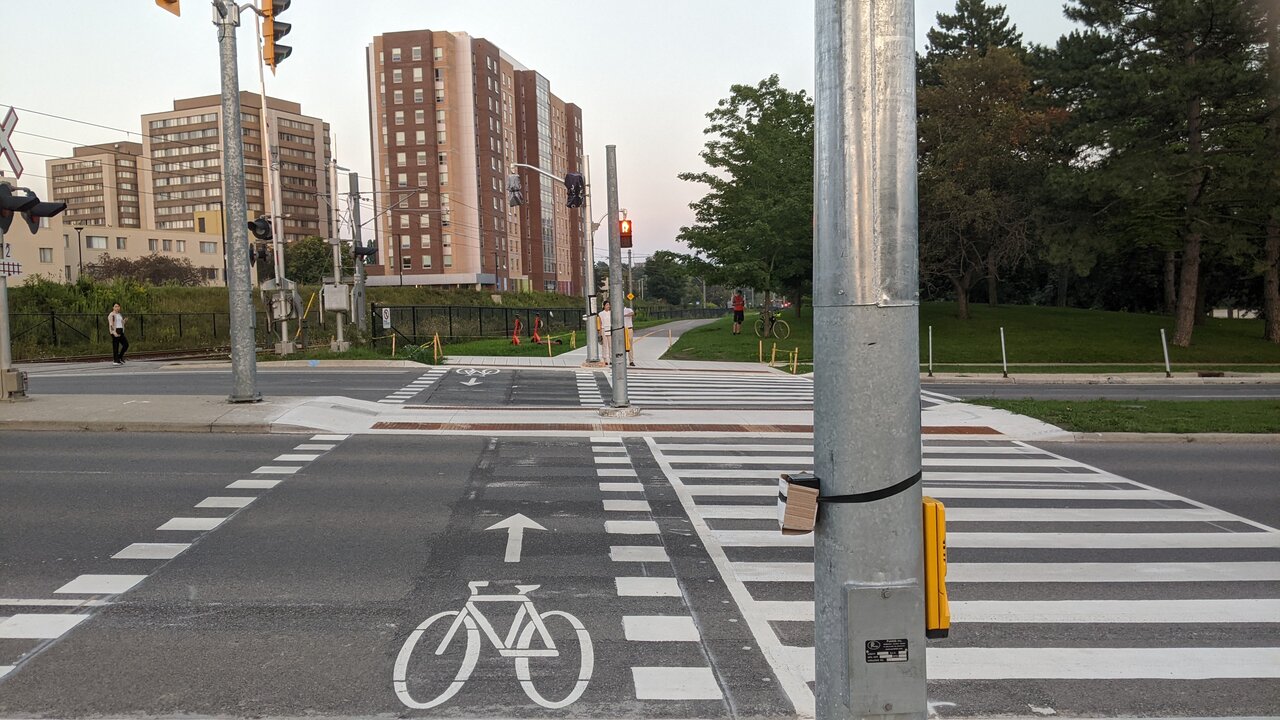

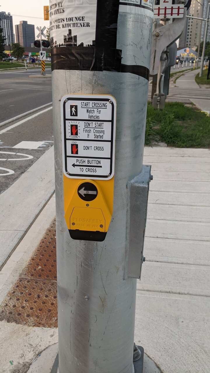

Not Toronto, sorry, but does anyone here know anything about these new pedestrian crossing signals they installed a few weeks ago at the University Ave/Laurel Trail crossing in Waterloo?
They feel much more responsive from the pedestrian end to me (i.e. often pressing the beg button will immediately turn the vehicle signal yellow when there's no incoming traffic, and the ped light will immediately turn green if the button is pressed while the ION crossing gates are down, which didn't always happen before). Would love to know if there's anything meaningfully different with this new system, and whether these improvements are coming to other pedestrian crossings in Ontario.
When the signalling was rebuilt here, they also reconfigured the crossing to be a much wider separated ped + bike crossing, instead of the narrower shared crosswalk it was before. It looks like they've installed a traffic light (and separate beg button?) for bikes, but it's covered up for now.
I used to cross this intersection several times per day, and I still cross it very regularly. It gets a lot of foot and bike traffic. I'm really glad it was improved, the signal timing used to really bug me.

View attachment 501305View attachment 501306
The operation you describe is known as uncoordinated operation. So the signal sits in the main street for some minimum amount of time, after which it responds immediately when someone presses the button.
This is possible with pretty much every traffic signal. It's not an equipment limitation it's just a question of priorities. In most places they don't like it because it can interrupt waves of cars, but it's far better for pedestrians, cyclists and transit priority.
There are some uncoordinated bicycle/ped signals in Toronto (e.g. Finch Hydro trail at Norfinch, Grantbrook and at Talbot), but they programmed a main street pedestrian signal in the timings even though there is no pedestrian signal across the path. So when it detects a pedestrian or bike, it waits 5 seconds for the pedestrian countdown on the non-existant pedestrian signal.
All it would take to resolve this issue is to change the main street recall mode from "pedestrian recall" to "vehicle recall", which is a matter of pressing a single button. But the city doesn't do this because it's not in their procedures. So at all uncoordinated pedestrian/bicycle signals in Toronto, pedestrians and cyclists always need to wait 5 seconds for no reason whatsoever.

Universal Truth #2 is busted, but currently nowhere to my knowledge in Ontario sets up hand flashes during the yellow or red clearance, at least with a traditional signalling scenario. (Not counting situations like pedestrian scrambles)
I know Hamilton used to Don't Walk flash into the yellow phase, but that was discontinued when the countdown was introduced sometime in the late 20-aughts or early 2010s.
With my experience in downtown Toronto as a pedestrian, the steady don't walk is the main signal that pedestrians respect. I understand what you're saying, a longer walk phase can be shown by extending the flashing don't walk right until the cross street gets their leading pedestrian interval. But watching pedestrian behaviour, you notice that the vast majority of pedestrians do not obey the flashing don't walk at all. My guess is that extending the walk signal display time, by making the steady don't walk appear later on won't change how pedestrians behave in regards to the flashing don't walk.
Besides, the amount of time that is chopped off the steady don't walk is almost negligible, a four second amber plus a two second all red is 6 seconds. More recently, downtown Toronto has dramatically shortened the amber to 1 or 2 seconds, I'll get back to that point later, so even so, now that time which is lost is a mere 4 seconds.
Also, somewhat ironically, I've always felt that the countdown actually encourages pedestrians to enter the intersection on a flashing don't walk signal. As the countdown implies to many pedestrians the amount of time they have left. "I see 8 seconds left, if I walk fast I can make it to the other side). I understand that's not the intended purpose of the countdown, but I'm sure most pedestrians see it the way I'm describing it. When before we had countdowns, when the steady don't walk would appear would make you less likely to enter during a flashing don't walk.
