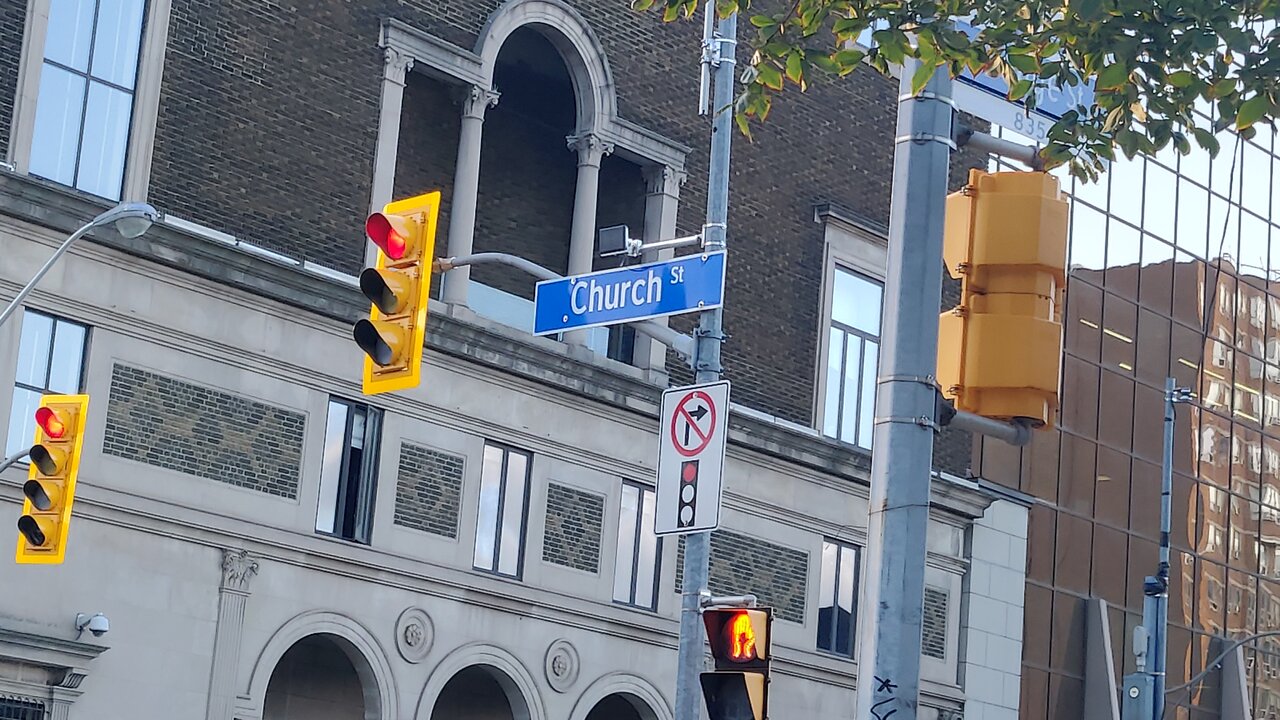

What is this device mounted above the blue street sign?
Usually I've seen those (larger gray box) on the side of the road pointing downward the vehicles perpendicular of the direction of travel near the stop line..
