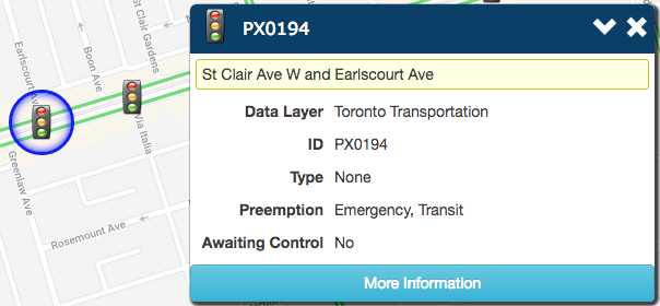

And even if someone did that, it wouldn't be as great as you might think because the priority system is designed based on the anticipated travel characteristics of the transit route. Remember that in order to provide a green light when you arrive at the intersection, the system needs to have a prediction of when you'll arrive at the intersection. So to get the full benefit of priority, you'd need to stop your car for the expected amount of time at each transit stop, which kind of defeats the purpose of hacking into the signal priority.
For this same reason, emergency vehicles do not use the transit priority system. Fire services has their own pre-emption system which is much stronger than the transit priority system and is equipped at 50 signals near fire stations. In the City's Open Data (conveniently displayed here), you can see which system is equipped at each signal. For example, signal #0194 St Clair & Earlscourt is equipped with transit priority (for east-west streetcars) as well as fire pre-emption (for southbound fire trucks coming out of Fire Station #342:
I'm not sure about Toronto, but ambulances and fire trucks have their own signal priority system in parts of York Region that keeps lights green or turns all lights red until they've gotten through.

It is possible that the poster was thinking of a system used in some municipalities (in my observation, fire only) where a vehicle-mounted strobe triggers a pole mounted sensor to interrupt the sequence to either green in favour or all stop.
