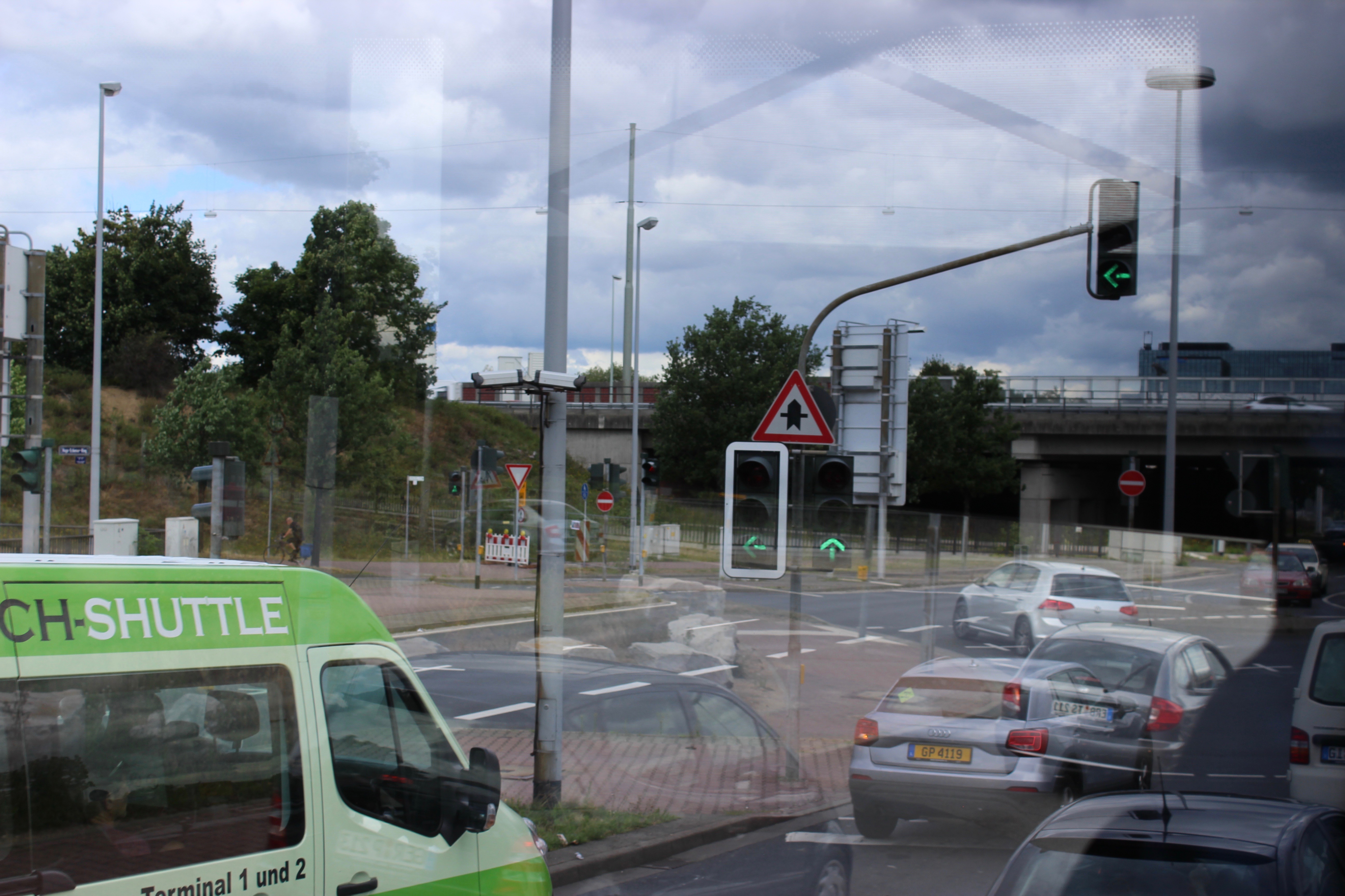

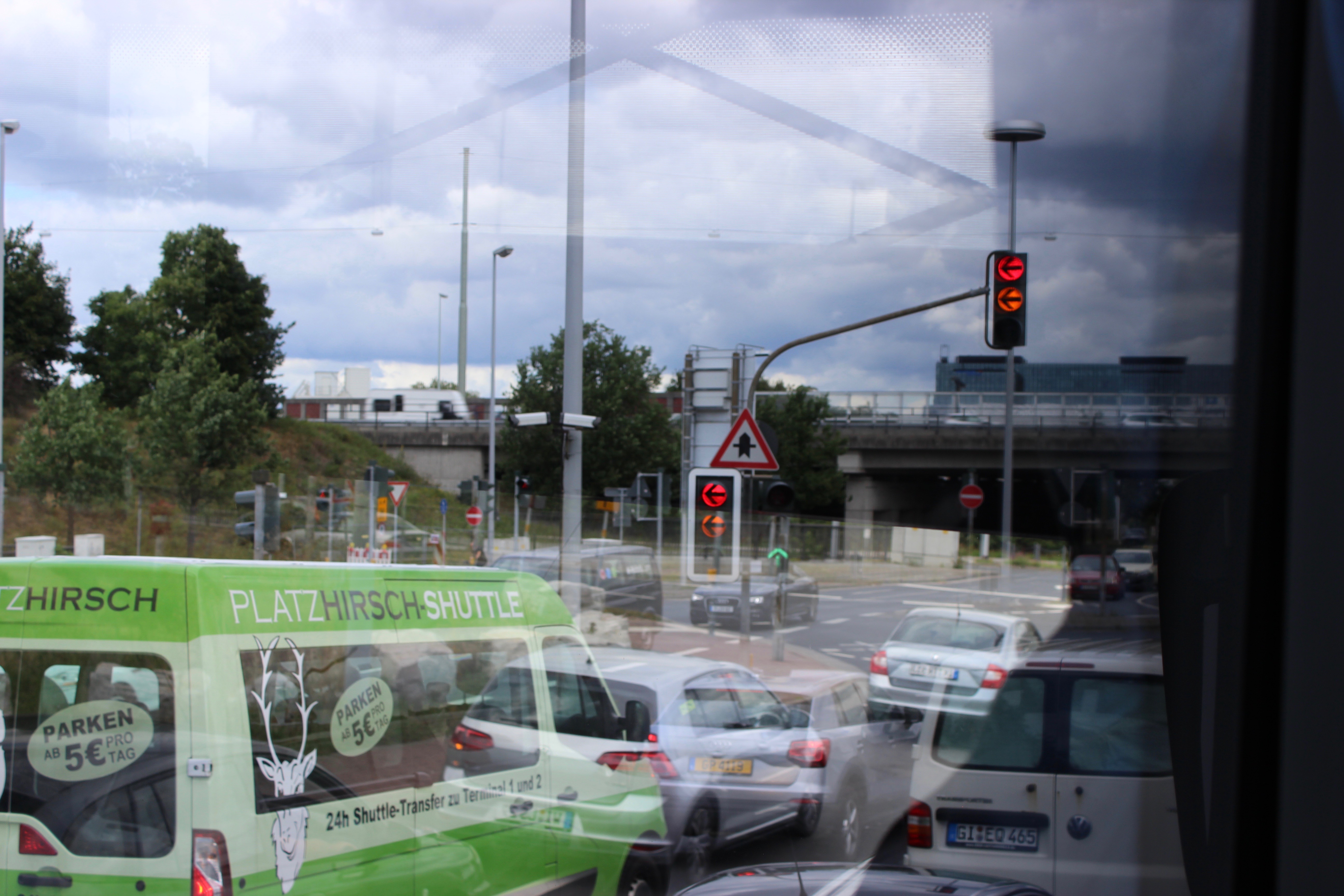

These photos I took in a non-English speaking country. Without a sign explaining what they are, what does the traffic signals mean to you?
Yet Ontario requires the use of English signage, so that the people from Quebec and Mexico would not read them.
No idea.
1st one. Go straight. Can't turn left. Orange means some special vehicles can turn left (maybe buses).
2nd one. Can go straight or turn - have full right of way.
