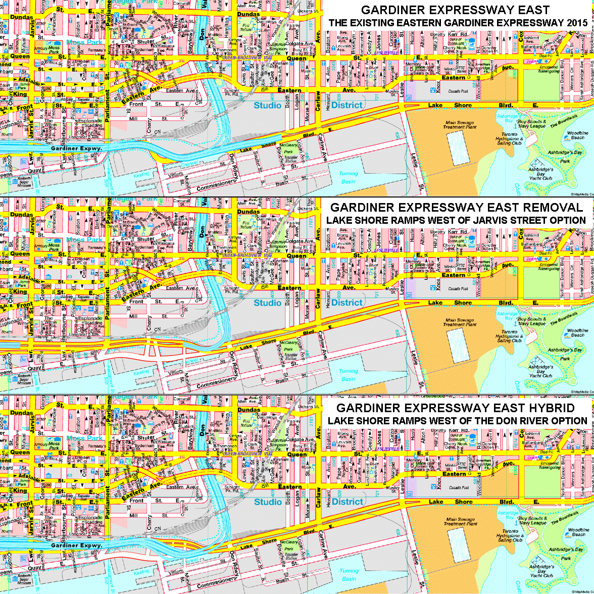

You'd probably get most of the "hybrid" votes if those fly-unders are included with the boulevard option. Most of those who support the hybrid do so because it retains a non-stop link between DVP and Gardiner.
I thought the boulevard option had ramps between the DVP and Gardiner? Like in the middle image here.
I believe the main point of opposition are the traffic lights and concerns for through-traffic not bound for downtown.
