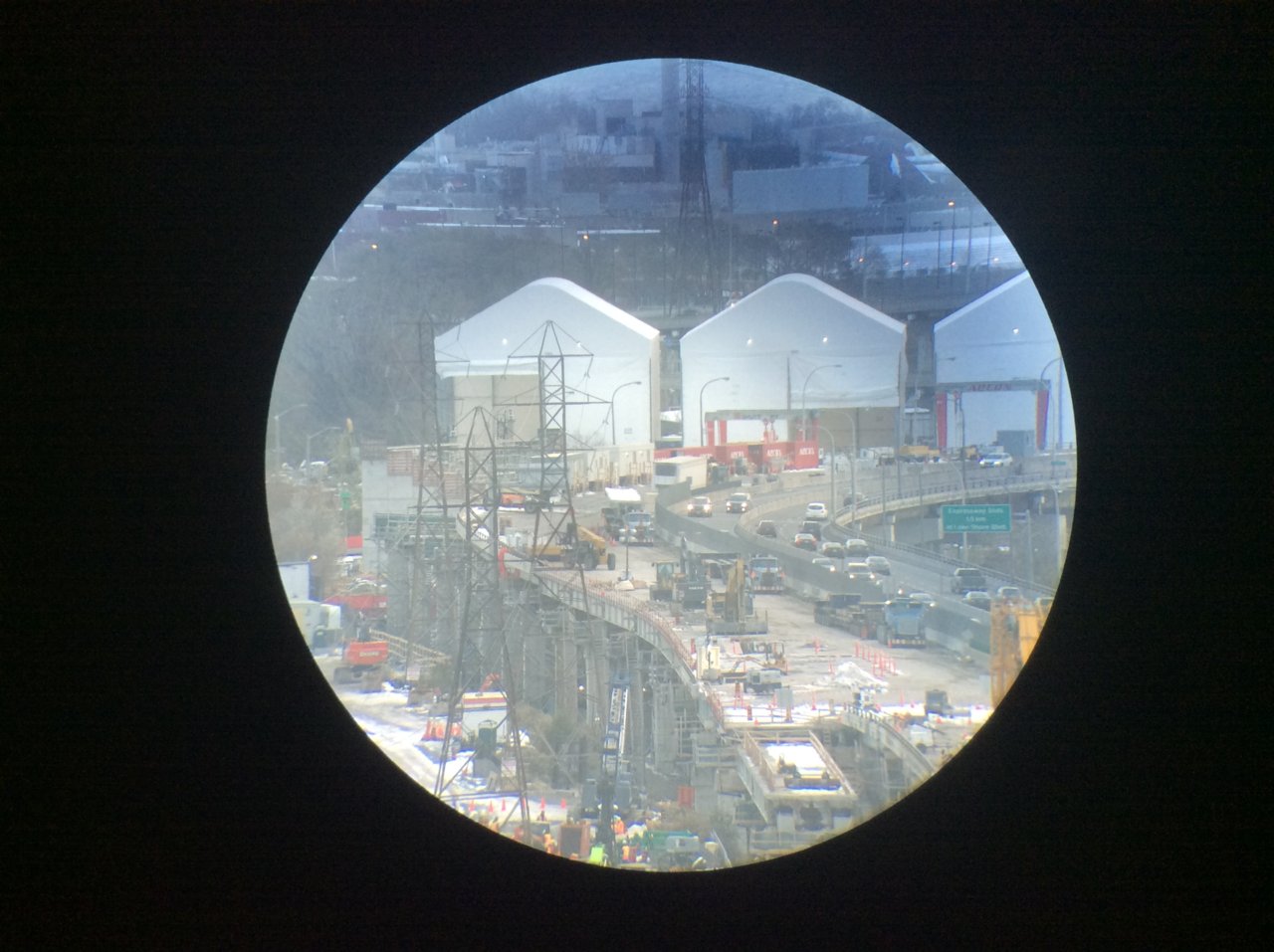

Does anyone know what the giant concrete embankment being built on the upper left portion of the photo above is for? Could that be the new ramp for the Lakeshore exit?
Gardiner East realignment hasn't started construction yet, I believe that is some sort of servicing facility to the west don lands, unrelated to the Gardiner.
