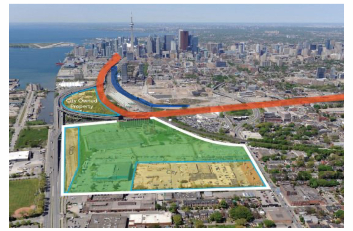

I’ve never understood why they don’t build a new elevated portion over the Railway starting in east downtown and tighten the curve…. Why not put the highway above the ugly railroad? I marked this in blue in the attached…. That way this NEW section can be built before they tear anything else down and get Toronto moving again by connecting the new portion above the rails to the existing elevated Dvp and Gardiner sections … what am I missing?
Any activities over Metrolinx corridor requires flagging protection/working at night. It’ll be a pain to coordinate construction activities and any future maintenance/inspection work around rail traffic.
Not saying is impossible for the City/MTO and Metrolinx to work together and sign some project specific agreement/easement but it is a bunch of paperwork/coordination that apparently no one wants to do.
First off, where is the room to put in the bent support on the side of the existing corridor to support the main bean to support this idea??
Second, no room to put in centre bents without removing tracks 100% and DOA by Metrolinx right off the bat,
Three is o have Beams sitting on side bents will have be assemble in one piece to be lifted by a number of cranes, but most of all, the underside if the beam has to be 35 feet above the track.
Four: Given the span, the weight of 6-8 lanes of traffic, the depth of the beam could be 15 feet or more and leave that to the engineers who may have a better idea.
Five: Given the length of the supporting beam, where do assembly these monster beams??
Six: You need to move the ramps to/from the DVP further north due to the increase of height as well make various changes to the Gardiner to get to the new height that will require the closing of the Gardiner up to a year.
Seven: Metrolinx will require strict protection over the corridor at all times that will not interfere with train movement or nighttime work.

A solution that frees up some local space, but complicates any future upgrades to the rail corridor .. may not be environmentally friendly, if we look at the big picture.
Given the importance of this rail corridor for public transit.
